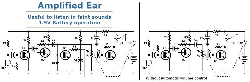

The electret mic is operating at such a low current that its impedance is 10k ohms. The 100nF capacitor in parallel with it has an impedance at 2kHz of only 800 ohms so it is a "short circuit" at a mid frequency.
The 47nF capacitor to ground is also a "short circuit" at a mid frequency.
They kiss the high audio frequencies, "Goodbye".

Instead of the Talking Electronics project with its very narrow audio bandwidth and high distortion, this circuit project be used: Amplified Ear - RED - Page38

Instead of cutting all the mid and high audio frequencies, remove the 100nF capacitor across the microphone and remove the 47nF capacitor at the base of the second transistor.
To avoid acoustical feedback howling use headphones that seal (over the ears or that fit tightly inside the ear canals) and move the mic away.

AG, I checked the freq. response of the ckt. using PSPICE & I got to know that high freq. response & the max. value of gain is mainly affected due to the 47n cap. while the 100n one across the mic. hardly affects. So, I have removed it from the ckt. Whereas previously only while making the layout I had kept mic. away from the spk.
Thank U Guys For Ur Help!!!:)
Your Pspice is stupid and doesn't know that the electret mic that is operating at a very low current is a high impedance. It thinks it is a very strong 30A generator.
In my simulation I have the electret mic with a 10k ohms impedance. The resistor divider that it feeds in parallel with the 100nf capacitor causes 1416Hz to be down -3dB and higher frequencies are reduced more. The 47nF capacitor also cuts high audio frequencies. The result is a very muffled sound.

[Acc. to PSPICE] For an i/p of 5mV, max. o/p at collector of 3rd transistor is just about 9.5mV although I removed the 2 caps. Whereas Collin told it is 1.5V?
colin55
The collector of the second transistor will swing nearly 1v and thus the output transistor will swing almost 1.5v but it will have about 100 times more “current” to drive the earpiece and achieve the greatest volume.
If the 10k of mic. not considered then upto 39.5mV. This wouldn't be enough, would it? Plssssss explain.:confused:
The simple circuit is not biased properly and does not have any negative feedback.
The result is severe distortion.

The resistor b/w the C & B in biasing of 1st transistor is not named. I think its R2 1MΩ. Pls. tell me am I correct/not?
Also does the pot behaves as a volume control? or else what? And does it help in avoiding motor boating?

The BC547 transistor for Q1 has a wide range of current gain. Its average is about 150 at the 0.1mA used. Then the collector voltage will be about 1V and the base voltage will be about 0.58V and the base resistor will have a voltage drop of 0.42V and a current of 0.67uA. Then its value is 62k ohms.
C5 has a high value of 470uF that will prevent motorboating.

But in ckt. expln. its given that "This operation is accomplished by Q3, modifying the bias of Q1 (hence its AC gain) by means of R2." From this the unknown resistor has a value of 2MΩ(as per given) & u r calc. as 68kΩ. Which 1 2 be taken? I am going to solder the components in 2 days Pls tell. Also in place of 2k I got a 4k7Ω pot. Will it be OK?
Correct. But you are making a different circuit.
No.
1M (R2) plus 100k (R7)= 1.1M, not 2M. The 1.1M connects to +1.5V. My 62k connects to only 1.0V.
Which 1 2 be taken?
It depends on the current gain of the first transistor which could be 60 to 400. I calculated for a transistor (with a current gain of 150 at 0.1mA. If your transistor has higher current gain then the collector voltage will be too low and the base resistor must have its value increased which is quick and simple.
Use a BC547B transistor if you want it to work with a 62k or 68k resistor. The BC547B has its current gain selected for a narrower range.
Then the gain of the circuit will near half. The volume control pot is supposed to be 22k, not 2k.
