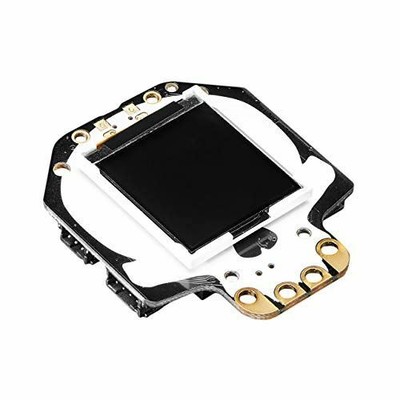

You can buy individual ready built (uncased) eye modules that have both the MCU and display built in, from suppliers such as Mouser:
Or at a rather higher cost on ebay:
Thank you I have actually ordered two of the hallowing m0 expresses last week. Is there way to chain them together like the referenced project ?
If I understand it correctly, the sudomod code on github can run up to four displays (screens) per MCU; that's why there are chains, one module presumably contains a display and the MCU, the others only have displays.
I'd guess you could also daisy chain up to three extra displays from the integral MCU/display module.
