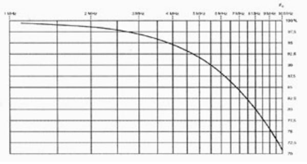

How much this cro worth in states and canada ?
$20 if it is in working order, nothing if it has a fault of any sort.
These were made in the millions under various names back then and you can often pick them up for free these days - I've still got mine, but it hasn't been used in the last 20 years or more.
I gave mine to a movie studio requesting props from a 1980s electronic lab a few years ago. The exact same scope was sold under various brand names in the U.S. I'd call it a boat-anchor if you have to put any time into repairing or tuning it up - if you don't need a boat anchor, charge a disposal fee to the person trying to get rid of it.
