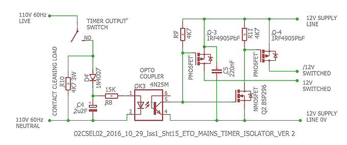

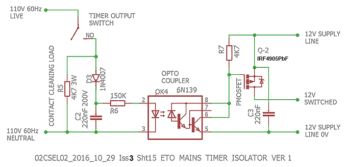

Hi AGCB,
Below is a circuit for an isolator between your mains timer and 12V power supply. The components are all freely available and low cost: total about $4US.
spec

NOTES
(1) C3 is Ceramic X7R dielectric, +- 20% or better, 18V working or higher, thru-hole (not surface mount) C3 can also be polycarbonate.
(2) C2 is polyester or polycarbonate dielectric, +- 20% or better, 200V working or higher, thru-hole
(3) Resistors are metal film or metal oxide, 0.5W or better, thru-hole, 200V or higher, unless otherwise stated.
(4) R5 can be wire-wound or ceramic, 3W or greater +-20% or better, 200V or higher.

In paragraphs 2 & 3 of post #1, the reason I did it with the NC contacts was so that if the mains power went out at night the door would remain closed.
From what I can see in the schematic, if the mains power went out it would result in no 12 V power at the output and the door would open.
My brain is a little foggy this morning but I think this could be changed. Maybe a N-channel MOSFET (lo side switch) and possibly needing a PNP transistor to reverse the output polarity of the OPTO or possibly just reversing the leads. Do we really need a darlington OPTO? I have several 4N26
Am I making any sense? Good chance not!
I think the same problem exists with using a SSR as crutschow suggests because there is only NO contacts
Aaron

In paragraphs 2 & 3 of post #1, the reason I did it with the NC contacts was so that if the mains power went out at night the door would remain closed. From what I can see in the schematic, if the mains power went out it would result in no 12 V power at the output and the door would open.
Got it. I didn't fully understand how the door opening and closing worked, but nothing that can't be sorted.

ACGB, will this do your job:
I did the above circuit before I got your post #12 above, where you say that all you want is for the PMOSFET to turn on when the timer relay opens. If that is all you want, PMOSFET Q3 and C5 (220nF) can simply be omitted.
spec

So as you have it drawn w/ the 3 MOSFETs , it's like a SPDT relay. By removing Q3 it becomes like a SPST. Correct?
I've made some logic level MOSFET switches using a bipolar transistor to change the output polarity of whatever and increase gate voltage to the MOSFET.
Could I substitute an IRF510 for Q2 because I have them on hand?
Aaron
Yes, similar.
Yes, that is correct.
Not too sure what you mean here- could you post a schematic?
Yes, an IRF510 will be fine.
