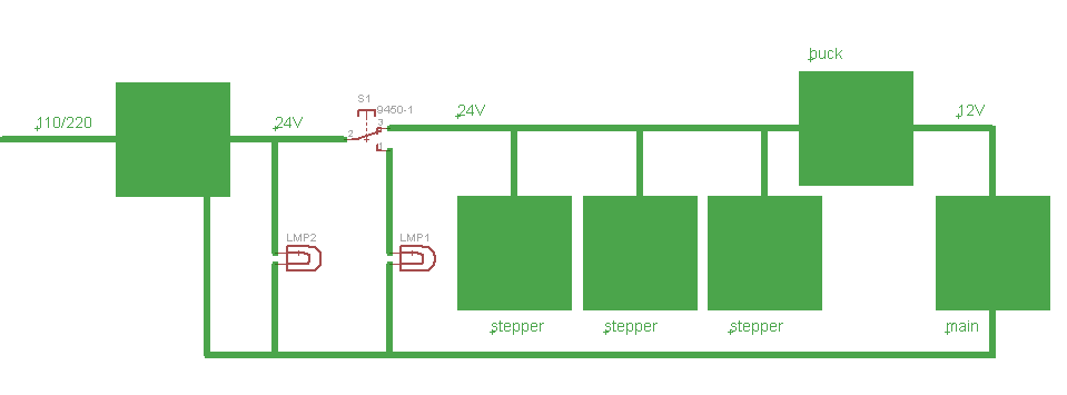

I have an emergency stop button that is cutting the 24V power to the stepper controllers. One of the LEDS lights up and is wired in series with the fan so when you turn the fan on the LED comes on.
The other LEDS one comes on when the main power is turned on. The other one is then required to come on when the emergency stop button it plugged in and off. However obviously as I want to cut the 24VDC supply I cant wire the 12V LED in series like with the fan. As I have two supplies that's why I was thinking of the relay. Am I correct in thinking a SPDT Relay would would however I'm not sure on the type required as from looking at the types there are many different types. I was wondering if something like **broken link removed** would work.
What model # led do you have?
The 12V fan and 12V LED in series with each other, is that powered by the 24V supply?
I think you want to use a relay because your switch is not what you want.
I am using a SPDT switch. "lamps" are 24 volt. We can probably make the 12V LEDs work on 24V by adding a resistor.
I bothers me that you are using a 12V LED and a 12V fan in series on 24V. That probably should not work.
Can you power the fan from 12V?
Is the diagram below right?

As Frozenguy has hinted at, the "12V" LED that you already have will be able to work at 24V, but only reliably with an additional current-limiting resistor.
EDIT:
Cross-posted with ronsimpson - can you confirm whether ron's take on your set-up is correct, because the details from your posts so far are unclear.
