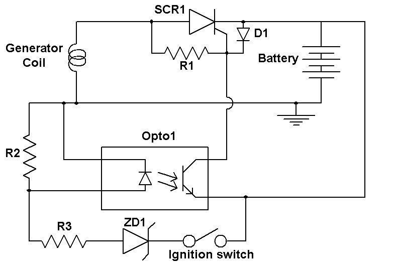

Here is the circuit as well as I can remenber it. It is quite a few years since I built it.
I found that the funny voltage spikes on automotive stuff is such that I prefer to use discrete components where possible. The same sort of reasons were behind me adding an opto-isolator when there is no isolation needed. The circuit is practically impossible to destroy by simple things like connecting wires wrong, or surges when the ignition is turned on or off.
I'm not going to work out values, but here is how it works.
The voltage from the generator is rectified by SCR1. Current through R1 will turn on SCR1. D1 will stop the gate voltage going negative on the negative half of the cycle.
When the ignition is on, and the battery voltage exceeds the voltage of ZD1, current (limited by R3) turns on the LED in the opto isolator. The transistor of the opto isolator bypasses the R1 current so that SCR1 never turns on.
R2 stops ZD1 leakage current turning on the opto-isolator.
It is would be perfectly possible to fit several SCRs for 2 or 3 phase generators. I was stuck with a single phase generator because the coil was shared with the headlight bulb, which was directly lit on by AC current.

Diver300,
looks really different to all the designs i have seen up till now. i'll try and model it and let you know how it works.

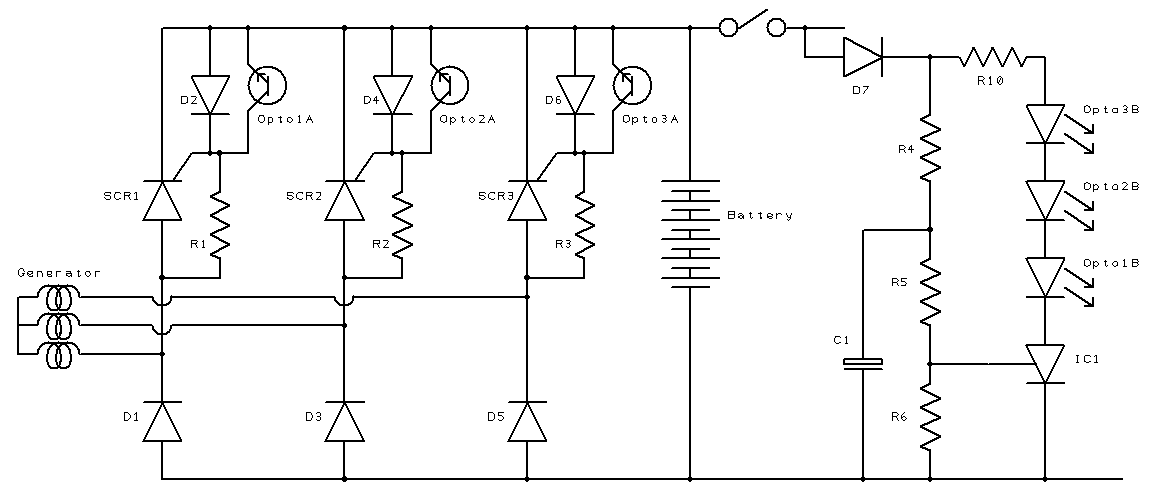

is there a way you could do the design for a 3 phase circuit? i'm a bit confused as to how you could do it.

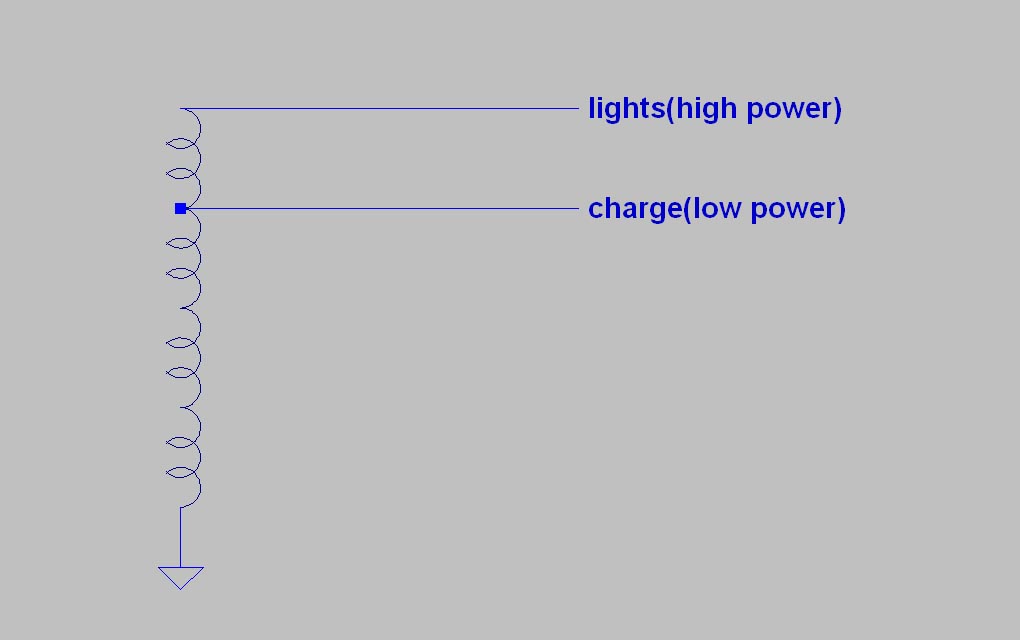

My XT 500 has crappy lights too. The headlight runs strait off the magneto. In fact it has a high power and a low power wires coming from the same coil. all that hooked up to the ground of the bike. the regulator is hooked up to the lights wire (high p) when the lights are on or onto the charge wire (low p) lights off. I want to take the ground off the coil (for full wave rectification) and change from 6v to 12v (thats why i need a good regulator) and last of all replace the battery by a big capacitor.

Here is an untested version for a 3 phase circuit. I have shown the opto-isolators separated on the diagram to make it easier to read.
IC1 is a TL431 or equivalent. The battery voltage is smoothed by R4 and C1. The voltage is divided by R5 and R6. When the divided voltage is above 1.25, IC1 turns on and turns on the opto isolators.
When the opto isolators are on they stop the SCRs from turning on by bypassing the gate current.
However, the circuits shown elsewhere in this thread would seem to be more suitable for 3-phase generators. The internal inductance of generators is so large that they can be considered constant-current supplies, so no damage is done by shorting them. The only reason that I built a circuit like this was that shorting the generator effectively shorted the directly lit headlight, run straight from the generator, not from the battery. Any motorbike with a 3-phase alternator won't have a directly lit headlight.

PS on one of the yamaha xt500 sites people have done the change to 12 v (there are plenty of volts) but you need to unsolder the ground (and resolder a wire)for full wave rectification.
if the regulator is hooked up to the low current wire that regulates the high current as well (they are on the same coil)
