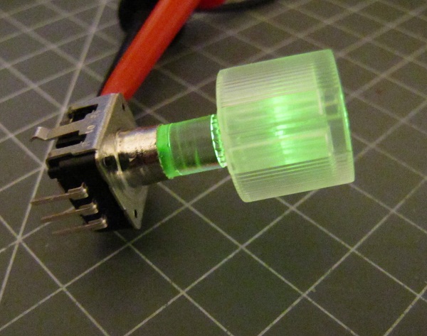

Found this encoder .. looks very useful for my current project . has Bi colour led and push switch... from uk supplier hobbytronics.com ( top is extra ) drawback has no threaded collar , so board will have to be mounted ..
Think it from sparkfun
https://www.hobbytronics.co.uk/rotary-encoder-rg
A link would be nice or something like a data sheet? Things like what does it encode and what is the resolution/output?
