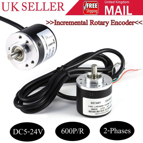

Hi Everyone,
I wanted to order an encoders for three of our inkjet printers but the prices from the inkjet supplier are ridiculous. I want to order one from shop and just wire it myself. The inkjet input for encoder has a weird set of cables and it is not clear to me which encoder should I use. There are four pins in 9pin Dsub:
+24V pin 1
0V pin2
+5V pin3
Input against ground pin8
I was not able to find any 2500 ppr encoder that matches this kind of wiring. May I ask for some wisdom here?

RVI58N-YY2YYR16N-02500, which has a 6mm shaft, 5V supply and 5V RS422 outputs..
It does appear that any general incremental encoder should work & it appears it only uses the two quadrature channels.
I'd try something like this, as an experiment:
Try it on the 5V supply first.
It would...

It looks like there are several type sold for that printer depending on the mounting type required...
eg. RHI90N-0LAAAR61N-00100
From the P&F datasheet,
That part number breaks down to:
RHI90N Series,
38mm hollow shaft,
Plug 9416, 12 pin
Radial cable exit
10-36V push-pull output
100 line count ??????
or,
It would need pull-up resistors to the supply as it's got open collector outputs. 1K should be OK for 5V, or 10K for 24V.
You may have to gear it up with a small timing belt & pulleys if the machine cannot take that low a count.
Solution
The printer is an industrial one, with a separate head for use over a conveyor belt etc. for product marking.
There are several different line count encoders listed by the printer makers, so I'm guessing there is some facility in the machine to calibrate the count to belt (& target item) movement?
