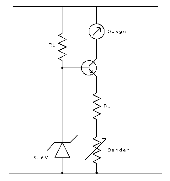

Alright guys, I'm a serious newb here. I used to be into all sorts of odd little electronic projects, but it's sort of all left me and I can't get my head around this problem I have.
In the real world, it's adapting a fuel sender that reads 60:eek:hm: empty, and 8.25:eek:hm: full, and need to use a gauge, that conveniently enough reads 240:eek:hm: empty, and 33:eek:hm: full. I need some serious help to figure out some way to raise the resistance at every point along the range of 60:eek:hm: to 8.25:eek:hm: -exactly- four times.
Possibile without anything too complicated?
TIA for any ideas you all can come up with.

A 9V zener in the line from gauge to sender should fix it. It would need to be rated at >3.5W so probably 5W.
If that actually would do it, that could be the ticket there. Simple solutions are always best, and I like that. If it works properly, I don't see how it could be much simpler than that. Thanks a bunch.
Justin
The 9V zenner is a good idea. However, there are two possible problems with it.
Firstly, if the supply voltage changes, for example from 12V with the engine stopped to 14V with it running, then the voltage remaining after the zenner (12-9 = 3 up to 14-9 = 5) will change a lot.
Secondly, the guage probably has resistance that is similar to the minimum resistance of the sender. For one thing, if the sender short out, it is a good idea not to have a lot of current and sparks inside the fuel tank.......
So if the guage needs more than 3V accross it to read full you won't be able to get to the top of the scale.
You should try to keep the resistance in series with the sender the same as what it was before.
I suggest:-
R1, the zenner and the Base-emmiter drop of the transistor provide 3V to the sender. R2 is the fake guage, so that the sender has the same resistance in series with it as it was meant for. Try to find out the resistance of the original guage that the sender worked with before, and use a resistor of that value.
Because the pair is fed by 3V not 12V, the current should be 1/4 of original. The transitor has a current gain of 1 in this configuration so that current is fed to the guage.
This circuit will not be affected by the supply voltage.
You should check the collector voltage when the tank is full. If it is less than 4V the transistor is saturating and you might need a more complicated circuit.
You can adjust the zenner voltage and R2 to get the guage to read correctly over the whole range.

A couple of notes though, you mentioned R2, there are two R1's. Did you mean to label one of them R2?
What wattage would you suggest for the zener?
Any suggestions on a particular transistor that would be suitable? NPN right? Would any old NPN transistor work?
Last thing I can think of for now is should the ground on the sender be the same ground that is used for the zener, or should that not matter?
I hope the 3.6v on the zener is good, because I don't exactly have a big box of electronics parts, I would have to order anything if I change it up... =/
It's been too long since I've even had electronics on my mind, please forgive my extremely basic questions :eek:. . .
Yes. The one in series with the sender is R2
There could be quite a lot of heat generated in the transistor so you need one that can take the power.
If R2 is 0 :eek:hm: then th.e maximum current is 3/8.25 or 0.36A. If the guage has little resistance, there will be 9V across the transistor, so the power will be 3.3W, which is large enough that you need a heatsink.
If the transistor's gain is 100, you need 3.6mA to the base, so allow 4mA, so R1 should be (12-3.6)/0.004 = 2100 :eek:hm:
If you use a 1.8 k:eek:hm: then the current will be 4.7mA so there will only be 0.0047*3.6 = 17 mW dissipated in the zenner, maximum, so any will do.
You can use any method you like to generate 3.6V at the base of the transistor.

Okay, well I did a considerable amount of extra work till I went back and looked at your post again. I'll chalk it up to a brain fart and not thinking hard enough :)
Well, this is what I found-
V- 7.12 off
8.10 idling
A- 88mA off
99mA idling
Resistance through the gauge- ~81:eek:hm:
Since I'll only be using one sender, it should be 40:eek:hm:
As far as the senders go, they're linear, so I'd think they should match.
This is what I'm thinking, lemme know if I'm on the right track.
Reverting back to your schematic-
-Bottom R1 (R2) should be a 40:eek:hm: resistor.
-The 3.6v zener should stay as far as we know because I'm cutting the voltage in one fourth the supply voltage from a straight +12-14v on my project car, not cutting the 7-8v that I saw *at the sender* in my running car.
-The transistor should be a TO-220 transistor in order to be able to add a heat sink. A TIP31? I actually have one of those so that would be good.
-What should I be looking at for R1?
Thanks!
Well done doing all the hard work. I would agree that the sender pair see 80 :eek:hm: and that one should see 40:eek:hm:
As the lower resistor is 40:eek:hm: and there will only be 3V available, the current will be about 75mA
There will be up to about 9V across the transistor so about 0.7W of heat in the transistor, assuming low guage resistance. If the guage resistance is high, there will be less heat.
The TIP31 has a dissipation of 62.5 °C/W on its own, so that only gives a rise of 44 °C so you would probably get away without a heat sink. I would bolt it to a little bit of metal on the circuit board, but more to stop vibration breaking the legs, which is likely as they are in a straight line.
The gain of a TIP31 is poor, but better at low currents. https://www.electro-tech-online.com/custompdfs/2007/11/TIP31A-DPDF.pdf page 5 says that 2 mA is enough base current for 0.3A collector current, so aim for that.
That gives the upper resistor as (12-3.6)/0.002 = 4200:eek:hm: but anywhere around there would be fine.
