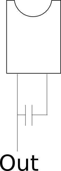

2. In my design, I'm contemplating on using a doubly-balanced mixer IC SA602AN . I've seen the two output nodes of transformers placed across the two inputs, and the two outputs of the mixer I've seen joined by a capacitor, and then using one node of the capacitor as the actual output. What's the point of this capacitor across both output nodes, and having an inductor across both input nodes? Does this have something to do with the "double-balanced" concept, that I don't really understand?

I've attached a pic of two pins of the IC joined by a capacitor, and using one pin as output.
Post the circuit of the mixer section. Your drawing was not very enlightening ;)

In the Neophyte, what's the point of C1 and C13? What's the point of C14, and R6, and R4? Also is there any rule of thumb for getting the oscillator on these chips to oscillate? Any simulation model, or equation to ensure that oscillation occurs? (Reading some docs about NE/SA chips, it says a large enough resistor shunted to ground should get the circuit to oscillate...) Any pointers?
C14 and C16 are coupling capacitors which take the audio from the output of the mixer to the AF amplifier.
Without these capacitors the DC conditions of the mixer and the AF amp would affect each other.
R4 and R6 provide a reference to 0v for the inputs of the AF amp.
