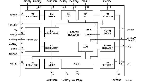

a simple radio can be made by using LC components im attaching one simple circuit chech out
