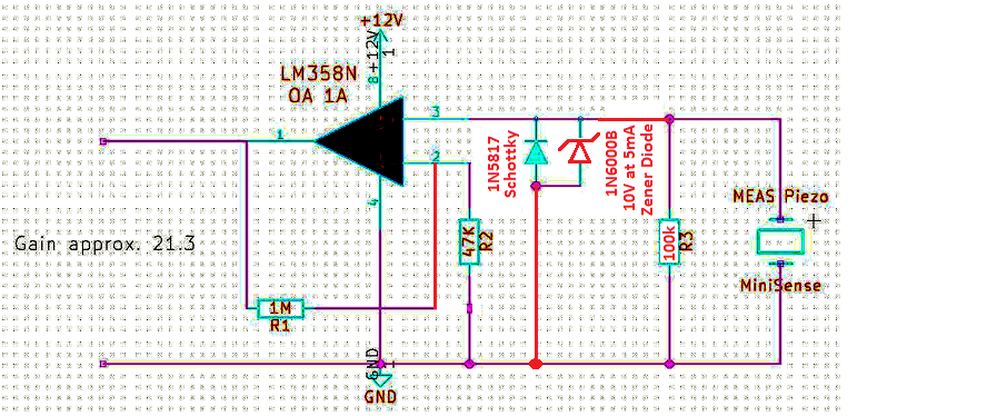

Thanks. Let me see if I understood correctly o_O
Something like below ?
Your HUGE negative schematic with a black background was hard to look at so I resized it and made it a positive with a white background (but it still has your chicken pox dots).
You had NO negative feedback so I fixed it.
10M for R3 is too high for an LM358 so I reduced it to 100k.
R4 did nothing so I replaced it with wire.
I provided part numbers for the diodes and corrected their ground connection.
How will you disable the second opamp in the LM358?

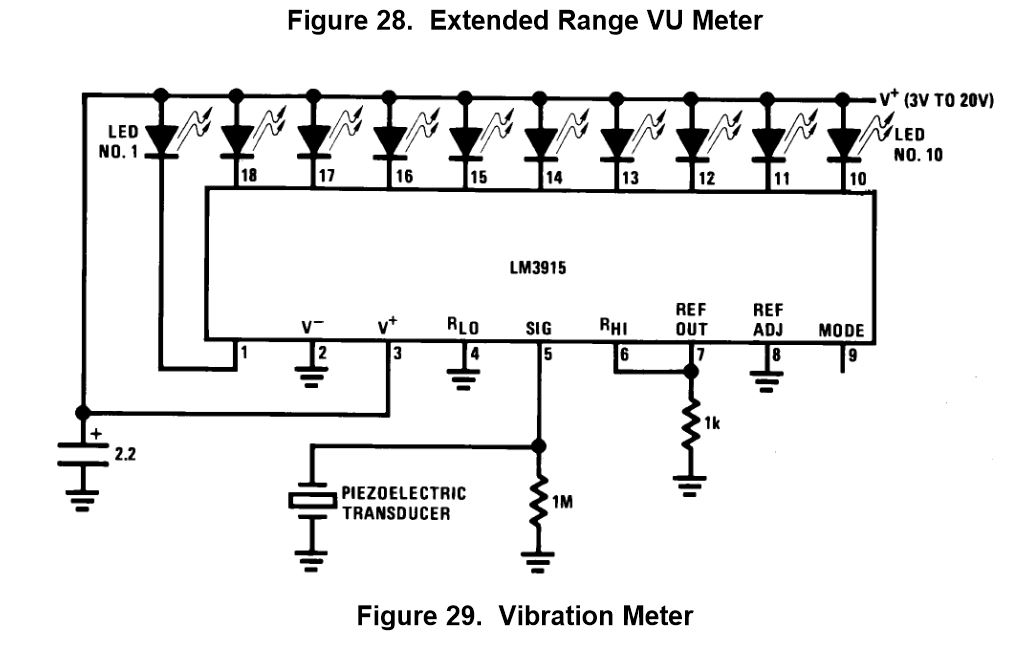

Working on the LM3914 and having thought that I burned one I went into the catalog of the store where I buy and by pure coincidence I saw that there are LM3915 and LM3916.
Looking at the datasheets of both I saw in the LM3915 the following schematic and I just do not know what the value of that capacitor is, connected between source voltage and pin 3, marked with " 2.2 ". From the + marking I see it is an Electrolyt one. Could it be 2.2μF ?
Could somebody help me to fiddle out that value ? I tried different capacitors I have but non did work. I took all my capacitors marked with 22xxx.

Taking reference to the prior posting I found a 2.2μF Electrolyt capacitor and tested now the circuit and it works nicely.
The datasheet says,
"Long wires from VLED to LED anode common can cause oscillations. Depending on the severity of the problem 0.05 μF to 2.2 μF decoupling capacitors from LED anode common to pin 2 will damp the circuit. If LED anode line wiring is inaccessible, often similar decoupling from pin 1 to pin 2 will be sufficient."
I think a 22uF capacitor might have too much inductance and less that 0.05 uF is not enough capacitance.
The LM3914 is a voltmeter. The first LED lights with 10% of the full range input voltage. The second LED lights with 20%, the third LED lights with 30% etc.
The LM3915 is a power meter. The first LED lights with -30dB of full range. The second LED lights with 3dB more (double the power of the first LED), the third LED lights with another +3dB (double the power again) etc.

Thank you. I read the data sheet a few times but that must have escaped me ...

Some sort of protection method should be employed because the transducer is a voltage source. I've actually used values to 100 K, but that's too high for your circuit.

This is not likely to do any damage to the OP amp so protection is probably unnecessary.
As I said earlier, the damage can result (with certain OP amps) if the voltage either exceeds the supply voltage by a small amount and the current is not limited in some way.
When an OP amp is UNPOWERED the SUPPLY is 0 V. So, the sensor could have been generating a voltage at sufficient current to damage the OP amp when it is turned off. That appears not to be the case.
The old original LM358 datasheet from National Semiconductor says the maximum allowed input was -0.3V and 50mA.
Since Texas Instruments recently bought National then all Texas Instruments datasheets for National devices have been updated. The latest datasheet of the LM358 from Texas instruments says the maximum input is 0.3V and 1mA and the output phase is undefined. They recommend an input as low as 0V, not a negative input.
Since they say to limit the input to 0.3V then I think a Schottky diode is needed in this application since we do not know how much current the piezo can supply.
It will be used for a second piezo sensor, The whole enchilada will have a horizontal an a vertical sensor in order to measure vertical and horizontal vibrations, The final stage will ahve a total of 3 sensors similar to an accelerometer eg. I will measure X, Z and Y axis.
Somewhere I said that I have also purchased an accelerometer with which I will start my test for the same purpose but have not yeet analized how to set the X, Z and Y outputs of the accelerometer to 0 (zero). Here a spec https://www.robodacta.mx/index.php?dispatch=products.view&product_id=85
As you see I still have a long way to go with my poor electronic knowledge ;)

BTW, the vibration measuring and optical showing using the LM3915 works great. Later this afternoon I will post the bread board circuit and measure the excitation of the sensor to get the LED 10 lit up. I used the exact same circuit I posted in message #50 and the LM3915 did not blow up :happy:
I forgot that the datasheet for the LM3915 shows a vibration meter circuit and a piezo transducer feeding a 1M resistor that works fine with the lM3915. Also, the LM3915 does not become damaged by negative inputs like the LM358 opamp. Then is the opamp needed anymore?
