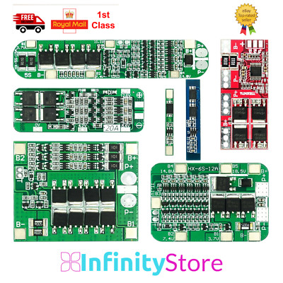

Suitable battery protection modules are readily available on ebay, amazon & aliexpress etc.
They are often labelled as "BMS" boards, battery management system - which is rather inaccurate, they are definitely not a complete management system!
For a single cell voltage, either one cell or two or more parallel so still the same voltage, you need under / over voltage protection and short circuit protection.
For two or more cells in series, it must also include cell balance, to avoid the cell voltages becoming uneven, as that is one of the common causes of battery failure or fire; if any one cell has a higher charge than the others, that can overcharge and fail before the overall battery voltage reaches the charge cut-off point.
Search eg. ebay for Lithium BMS and you will find a vast selection; a couple of example listings:
To find ones for a specific number of series cells, add eg. 1S, 2S, 4S or whatever the cell count is, to the search.
Make sure the module is rated at far higher current than the motor rating you will be using (presumably for a flywheel gun?)
Dc motors take many times the rated current when starting or if loaded so the speed drops down a lot.
And, be sure the cells are rated for an even higher discharge current! Too high current can overheat the cells and cause failure.

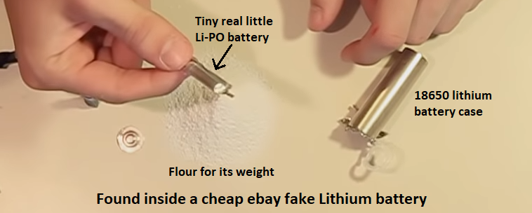

My electric radio-controlled model airplanes use unprotected 2 cell LiPO batteries. The airplanes have over-current detection and shut off the motor if the current is too high. The airplanes also detect low battery voltage then shut off the motor when the battery needs re-charging.
The airplane manufacturer supplies a 2-cell charger that works perfectly.
My local hobby store sells high quality Li-PO batteries that are not the cheap junk sold online.
Look at this online fake battery:

Buy a BMS board that has a good translation of its foreign language into your language.
Many have only Chinese instructions.

This looks like it could be suitable, if you use the external balance charger; it does not appear to have components for balance, only protection:
Or this one if you want to keep everything fixed in the gun, and just use a two-pole charge connector, though it would do no harm with the removable battery:
With either of those, the 0V, 4.2V and 8.4V connections are the battery (negative, cell to cell link & positive) and the gun circuit connects to the + and - pads.
Use an XT60 connector for the main battery connections, if you want to keep it as removable/swappable; the centre point tap only needs to be a smallish wire.
If you want to keep the balance connector on the battery, you will need a 3 pin JST pin header, with the middle pin connected to the BMS board 4.2V pad.
Or get a 2S balance extension & cut it down, eg.
The outer pins on the balance plug are only needed with the separate balance charger.
If you want to put the balance board in the gun and use a simple charger, you will need a 8.4V lithium battery charger; they are commonly used for bike lights etc., and usually have a "Roca" style connector, 5.5 mm outer and either 2.1 or 2.5mm inner.
You would then use a socket like one of these on the gun:
The charger wires would connect to the BMS + and -, the same as the gun power.
