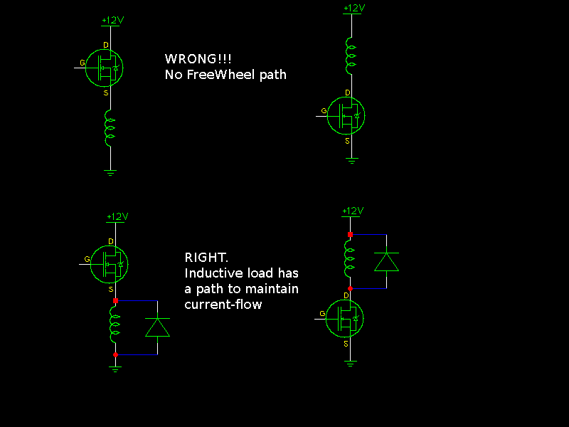

That external diode is in the wrong position to provide a free-wheel path IF you are switching an inductive load (say a relay).
No diode needs to exist across the switch. IT needs to be across the Inductor.
Now if such FET's were used in a H-bridge then their intrinsic diode can be used as a free-wheel path. They tend to be slow and are really not match to the main switches characteristic

NO!!! it is still in the wrong position, the anti-parallel diode in a FET provides NO free-wheel path for an inductive load IF the cct is a chopper-cct be it high-side OR low-side (see picture)

Anyway the intrinsic diode has more in common with a Zener then a regular diode, would you use a Zener as a free-wheel diode?
FOr low-power stuff (say a couple of 10's of amps) the intrinsic diode (WHICH is useful in a 4-switch H-bridge) the slowness of the intrinsic diode really isn't that much of a concern (unless you switch at silly speeds > 50kHz)
Thanks for the illustration. As soon as I saw it I realized I must have suffered another brain cell loss... I knew that! :eek:
