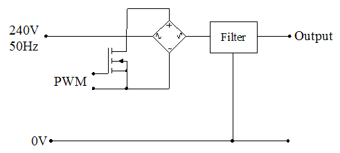

Just and idea but is it possible to make an electronic variac?
Obviously, the PWM frequency will need to be much higher than 50Hz.
Some snubbing before the filter will also probably be required.

A light dimmer is not the same as a high frequency PWM circuit.
That's true, phase control delays the firing of the triac which gives a totally different waveform than PWM.
The PWM circuit will chop the sine wave up in to many tiny pieces and the filter will smooth them all out to form a pure sine wave on the output.
There will be some voltage loss in the filter and a variac often steps up the voltage as well so a small autotransformer can be added to the input to step up the votage to say 270V (assuming we want 0 to 260V operation from 230V).

What you showed is a buck switcher. The output will be less than the input.
If you are looking for information on a similar think, look at PFC switching power supplies. It is a boost up type of supply. The error amplifier is very slow because you do not want to regulate part of the sign wave. (10hz response time)

I see what you're saying, as the duty cycle is varied the input voltage is divided by the same factor. However a buck is totally different, it only works on DC and a freewheell diode keeps the current flowing from the inductor when ther switch is turned off.

it won't work without 2 more FETs as the flying diodes since you need to conduct the inductor current when the switch FET is off in the proper direction.
You would be better off rectifying, bucking, and then using a power bridge to make it AC again.
Yeah, I know, the above circuit is for a typical DC buck converter.
I don't see how it's similar to my PWM variac circuit; I don't see how it can be called a buck converter.
A buck converter uses a freewheel diode or another MOSFET to keep the current flowing thorugh an inductor.
My circuit, just PWMs the sinewave and puts it through a filter.
Filter it how? A capacitor would instantaneously charge to the line voltage, and an inductor would, in it's attempt to keep the current flowing when the FET turned off, blow the FET.

The original "schematic" was more of a block diagram showing a FET in a diode bridge going to a filter block as a GIF file. ( I can still see it here )
There was no detail other than that. That is why I posted about the effects of different filter types on the FET and why people were comparing it to a buck regulator.

Are you talking about this circuit?
pwm-variac-gif.19571
You need to be logged on to see it.
I presume the filter would be made of inductors and capacitors and yes, I think thre might need to be a snubber network to protect the MOSFET.
I just don't see how it compares with the DC buck switching regulator shown below.
A snubber will not protect the FET. The energy stored in the inductor will overload any snubber you put there and blow the FET.
if you supply an 1A at 75V when the rail is 150V you will be drawing 1A at a 50% duty cycle. Normally the energy stored in the inductor is supplied to the load through the diode when the FET is off.
If you want to rectify-buck-unrectify you can do that, you can not just chop and filter.
