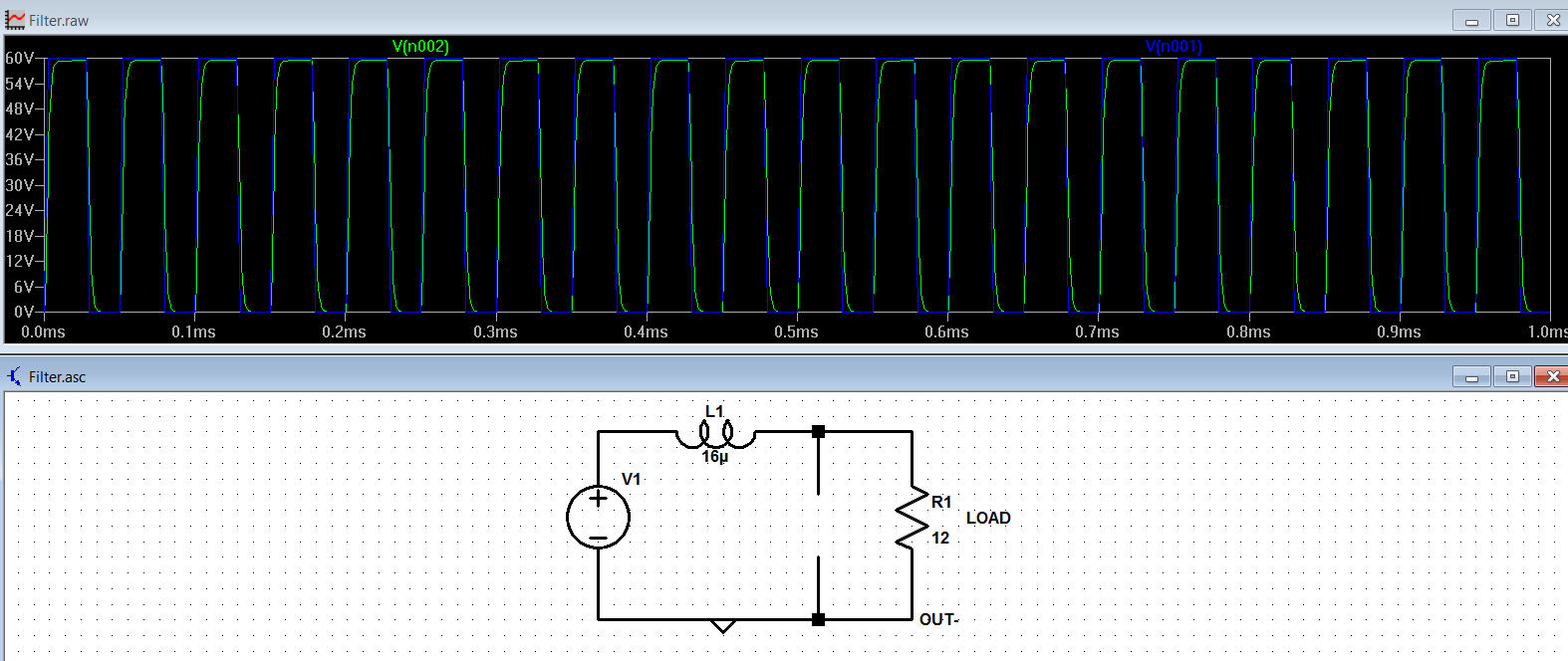

@ misterT,--- If you remove the capacitor near the motor you will get this:-

Well.. voltage across 12 ohm resistor has little to do with current through a dc motor.
I tried the circuit with my motor controller and a O-scope. using a 16u inductance does not smooth the square wave, so i kept increasing the inductance. I got a nice smooth linear voltage with 100u inductance. However, if i try to run the motor at higher speeds, the motor controller shuts down. Could someone explain the reasoning behind this please.

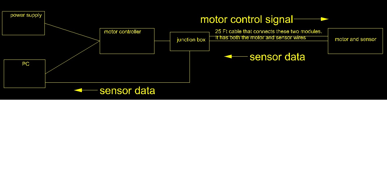

I have attached a rough schematic of my setup here. The motor controller and the inductor are pretty far from the sensor cable. They should not be a source of the noise. If i remove the sensor cable from the 25ft tube, there is no noise. But I HAVE to keep all the cables inside the tube. If i use a linear motor controller that does not use PWM signal all together, there is no noise even with the sensor cable inside the 25ft tube.

That can be a tricky one to solve. PWM controller does create a lot of noise. I doubt that you can solve this one with a filter on the motor wires. Try some of the things I suggested in previous post.. mainly twisting the motor cables and using shielded cable for the sensor (or motor).

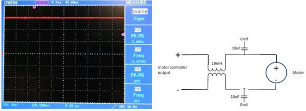

As I mentioned before, I can not change the cables. The one thing I dont understand is that, there is no noise when using a linear motor controller. So, i assume there should be no noise once I change my PWM signal to a linear DC signal. I also get a pretty good DC signal.( I have attached the image of the circuit and the linear DC signal I get) the peak to peak voltage in the linear DC signal is thus 2V, could this be the reason for the noise?

Could you measure the current in the wires?
Could you measure the current with an oscilloscope and post the graph?
I dont know how to measure current in a oscilloscope. does it need any extra probe?
Safest way is to use a 0.1 ohm shunt resistor in series with the motor and measure the voltage across it. You need to use two probes referenced to ground and measure the difference of the two channels.
