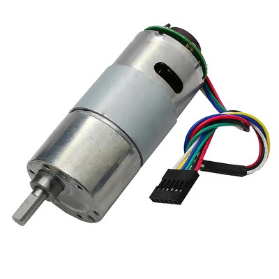

My experience with DC gear motors must be different than the rest of you guys. The gearing to me always seemed to make reversal take longer, due to the clearances needed in the gear teeth and the inertial of the gear train.
The motor in the photo looks more like what Max said a DC servo motor because most I've seen have that box for the wire connections.

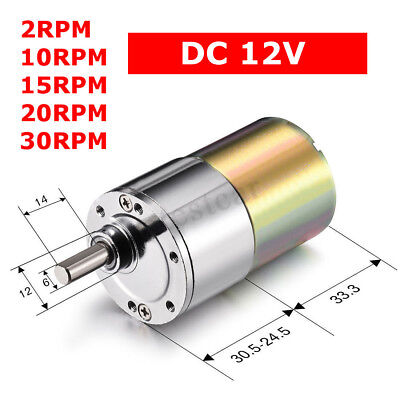

exactly, i was thinking the same, i'm thinking about a motor with smth like 1.5 or 2 Kg.cm torque
which i am looking at some dc motors coupled with a gearbox which is a 600 rpm at output /1.5 kg.cm(nominal) /12 V/2 kg.cm(max(or probably stall torque)

if i had any curve for these i would be pleased! these Chinese motors just give out those nominal things i said!
The TS doesn't say how big this is going to be. For something small wouldn't a stepper motor be a viable idea? Instant reversal with no brushes and commutator segments to worry about like in a normal DC motor, they don't like to be reversed instantly for any amount of times doing it.
that thing at the back of the motor is where the encoder is located! and i have seen the complete video, they use a dc motor with an encoder!
