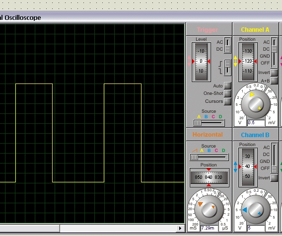

Hmm, I have managed to get this working, but I figure there must be an error in my maths or understanding of PWM :)
My maths says it's running about 62Khz at the moment, and I can dim the LEDs very to near off with no flicker.
My micro is running at 16Mhz, the timer pre-scale is set to divide by 1. If I divide this up into 8bit, I get the following ;
(16Mhz ÷ 1 ) ÷ 255 = 62.745Khz
Do the numbers sound right or am I overlooking something? As if I up the timer pre-scale to divide by 8, then that works out about 7.8Khz, but I can see the blinking quite easily. If I didn't know better I would say my values should be 62Hz and 7.8Hz respectively from an observational point of view :)

I am using an AVR :) An ATmega32 to be more precise, it was my understanding that they have no internal cycle divisions, in that clock speed = crystal speed, but I am unsure what I need to be looking at in the datasheets for the micro?
Just been reading the AVR d/s [ I dont use this device] it would appear you are correct, no internal division.:)

I can get access to a proper scope during the week, however the simulated scope gives me the attached image.
Now I am even more confused :)
The time/division is set to ~7ms, there are 9 divisions between each rising edge, so each complete pulse is 0.063 seconds. 1 ÷ 0.063 = 15.87 cycles/second, 16Hz? and 1 ÷ (0.063 ÷ 255) = ~4Khz
And the current duty cycle appears to be around 40%, 3.5 divisions high ÷ 9 divisions per cycle = 0.39 (39%)

:eek: The software simulator seems to have been set to 1Mhz, hehe, thus 1Mhz ÷ 255 = ~4Khz so I am reading the scope correctly :)
I wonder if the micro itself is set to an internal oscillator mode rather than use the external crystal, will have to check that later :)

Yes one of the AVR fusebits was set to internal oscillator mode, I forget what speed it was set to, but the pwm output on the new board seems smooth with a 8Mhz Crystal, so suspect it was set at this speed.
