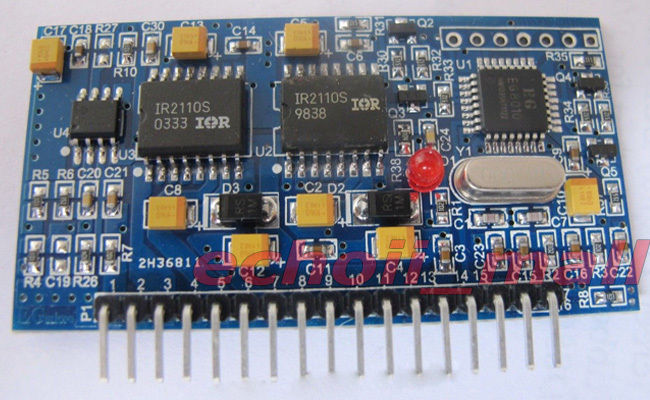

You can use AG's approach but use a switching (Class-D) audio amp to drive the iron-core transformer.
That should give efficiency comparable to other switching inverter designs.

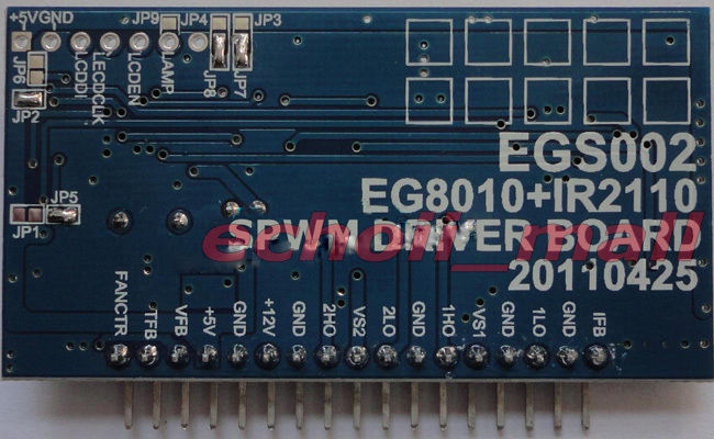

This is the driver board.

https://www.lz2gl.com/data/power-inverter-3kw/eg8010_datasheet_en.pdf Read this lot, this is how some of the commercial pure sinewave inverters work. The driver board is avalable on Ebay quite cheap, then all you need is the switching Mosfets & transformer. I agree with Nigel its cheaper to buy a ready made one.

Acording to the data sheet you can. I just used the board to make a replacement inverter for a generator. But it did not last very long before the switching MOSFETs were destroyed. Just gave up on that project.
I just posted a thread with a similar project. I plan on using a uC to generate the PWM to drive the H-Bridge.
