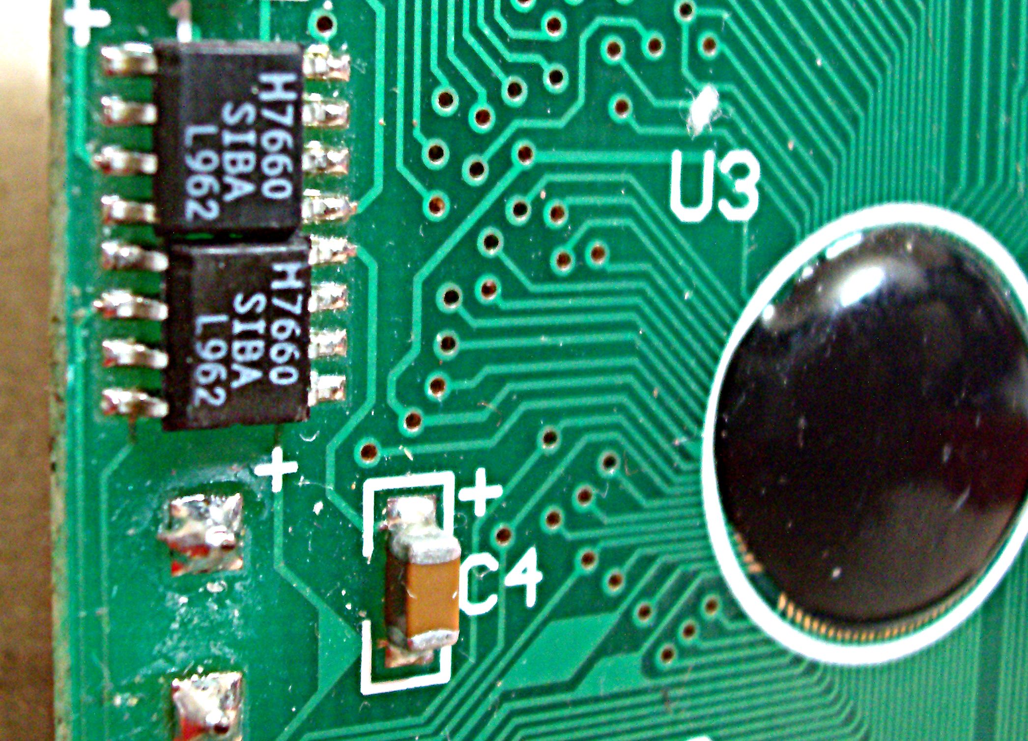

Thats a small picture :D
Im sure i can modify a old digital camera to it and take pictures also. If anything i have a cam that can take pictures really good. Ill take a pic of a pcb now (traces) and show you how close i can go.
Some quality sux but i had to put as JPEG so i can show all here unless you want a 4 mb file :D

i expect to check the PCB before any chips are on it to ensure there arent any cracks or broken traces. And if there are i plan to use a trace repair pen or something like a small thin flat wire to repair it. Even if i have to flatten a normal round wire under pressure and make a nice flat trace :D
Sorry, thought you were talking about checking the SMD solders and joints.
Every time I've had break in a trace its been pretty easy to spot. Hardest things I've had to spot are little bridges.
