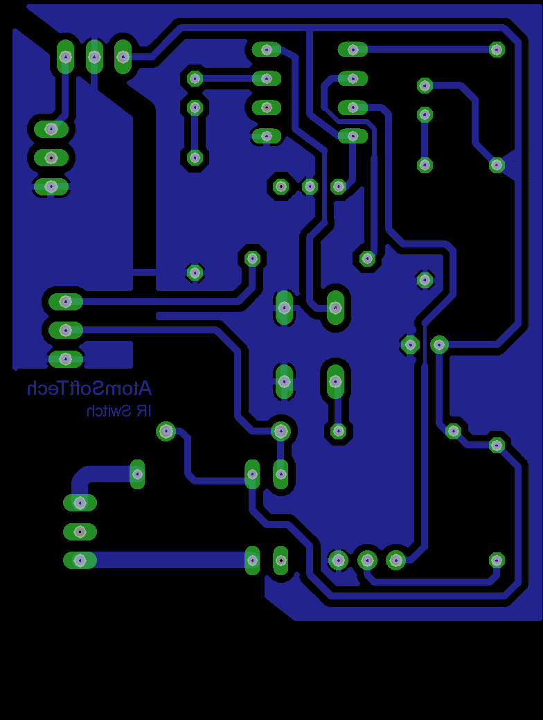

I think you know this already, but your text is on the top layer. If you want it to etch with your board and be readable, you need it to be on the bottom layer. Just use the mirror tool.
Since you are using the bottom layer (blue), you don't need to print mirrored. The bottom layer is already mirrored, so just print it as is. If you use the top layer, then you'll have to mirror when printing.

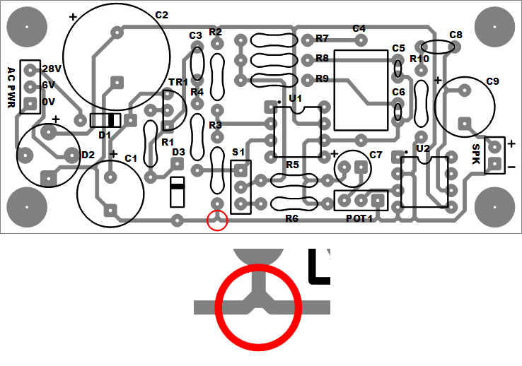

G'day Jason,
That second design does look a heap better mate, now what I do with my designs where a T or junction come off a track I put a fillet in each corner so the junction is alot thicker. If you add that then hero999 might not wet his nappies as after some of his replies to other peoples boards really makes one wonder if indeed he did wet himself.
Cheers Bryan :D
The fillet idea is great, have been wondering about how to make that look neat.
Thanks.

You use EAGLE don't you Jason? Then it is easy. Just select the polygon tool and draw a rectangle around your board on the layer you want the fill on. When you have done this select the name tool and click the polygon you just created and name it gnd. The polygon will fill in and give you a ground fill. I use the design rules to increase the clearance when etching my own boards so they are easier to solder.
A ground plane is a separate layer which is only ground - if you want to get technical.:p

Hey guys How do i change the rules on the ground plane? Like how it seems too close too me. How do i set the distance between the trace and the gnd?
LOL Mr RB....
Yea, Roman should change location from 'out there' to 'way out there' :p
to change the rules go EDIT -> DESIGN RULES... choose the tab CLEARANCE then adjust the space between track to track (WIRE)
or track to pad (WIRE & PAD) or pad to pad (PAD & PAD) .... etc.
EDIT: the change may not show up until you hit RATSNEST again

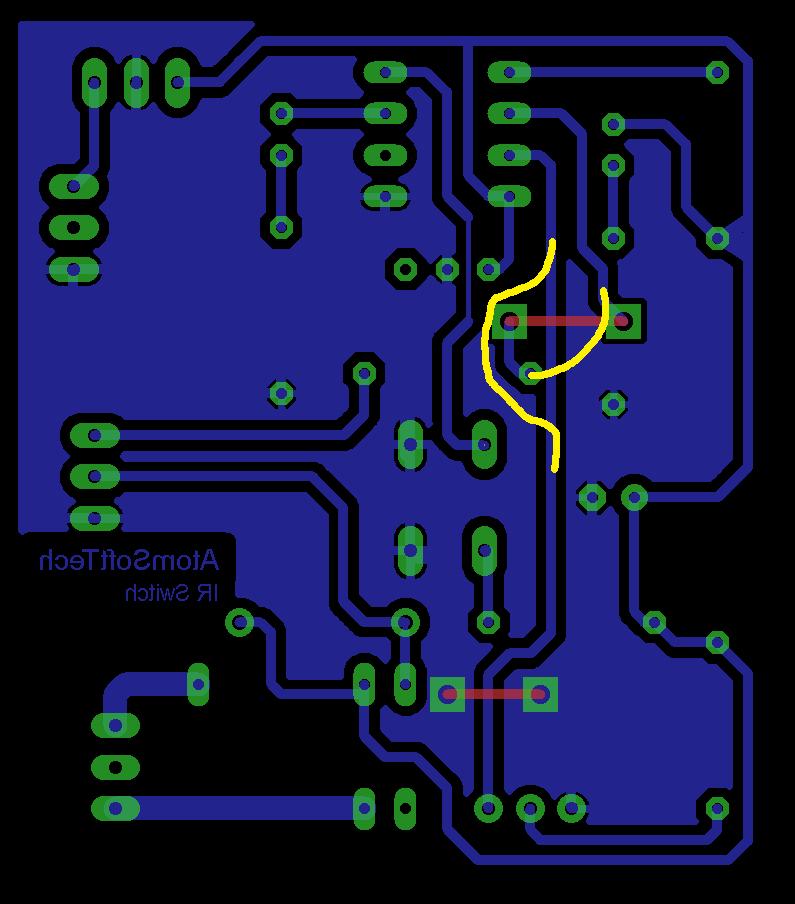

Possibly the device which fits the three holes on the lower right as I view the board could be 'flipped around' so its ground connection would be on the same side as your ground fill. This would eliminate the need for a jumper there, and would change the layout, perhaps...

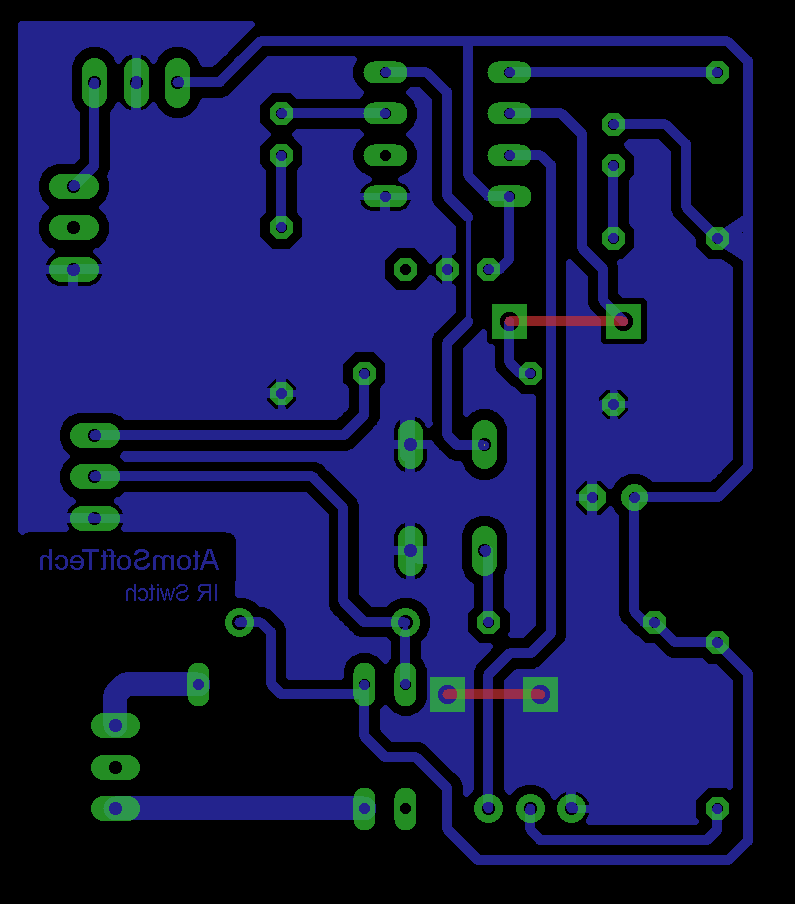

What I do is close the schematic file, then rename the board file (add a number to the end or something) then close it. The next time you open the schematic you can create another board with the 'switch to board' command. This allows me to play around with my designs... and see which I like best.
BTW, your board looks much better than the first one.:)
You can remove the top jumper all together just by moving the trace you are 'jumping' over around the thru-hole to the left.
See attached with yellow redraw.
You can increase the space between the ground plane and the surrounding traces/pads by increasing the 'isolate' value when you create the polygon. ..or use the 'i'nfo button on the surrounding polygon line and you can change all it's attributes after the fact.

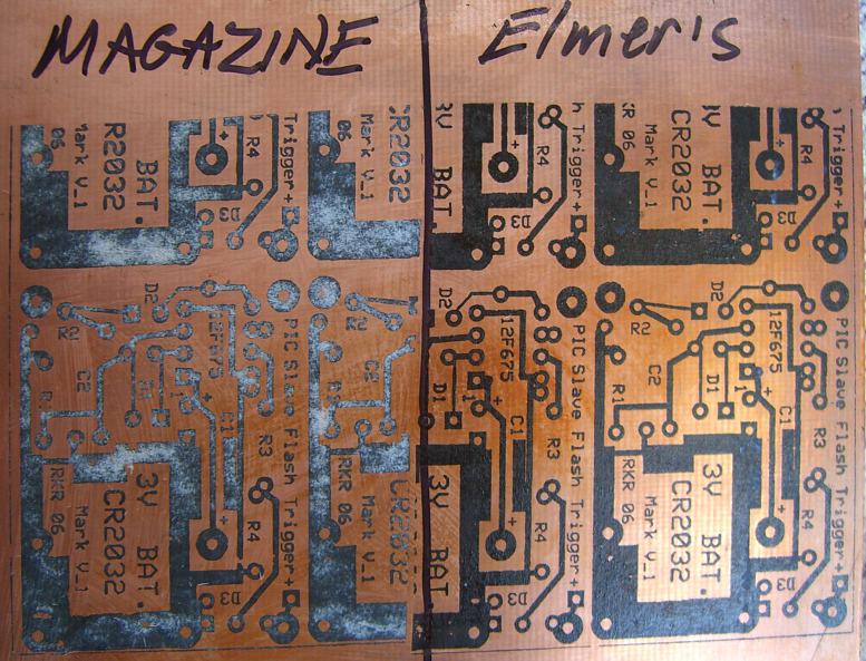

This morning I made a side by side comparison, both transfered at the same time, between a magazine paper and my Elmer's treated paper.
Elmer's treated paper slid off after a few minutes in hot water and you all know what I takes to get the magazine paper off. Note, that the hot water helped even the removal of the magazine paper tremendously.
I don't think it is too shabby:
