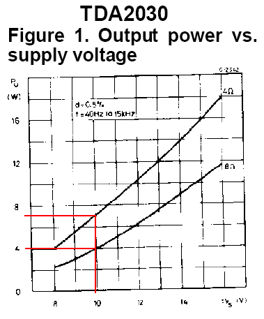

monkeytree said:
i want to make a power supply for an amp i built using two tda2030s.
You can't make a power supply for a stereo amp without knowing how much power ouput you need and what speaker impedance you have.
i have a transformer that gives out 15V
You don't say its current rating so we don't know if it will work.
A 15VAC transformer will make 19V after the rectifier bridge if it has about 4700uF of filter capacitance.
Each TDA2030 will provide 4W to an 8 ohm speaker and 7W to a 4 ohm speaker at clipping. Low power. Is that enough power?
and a bridge rectifier that can handel up to about 4amps at 50V (is that ok to use?)
Yes, for this low power stereo amp.
so that i dont damage the amp i wanted to regulate it
It doesn't need a voltage regulator. Use a 4700uF supply filter cap and it will be fine. Its max supply voltage is 36V.
