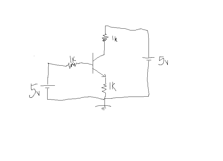

Am trying to learn a simple circuit simulation with Pspice. The circuit is attached. All the base, collector and emitter resistors are 1K. And supplies are 5V. With this i expect the base current to be 42 microamp. But somehow Pspice seems to show 1.19 mA. Am i right in my calculation or there is something i need to do with the Pspice ?
The transistor i use is Q2N3416. Somebody kindly help me asap.

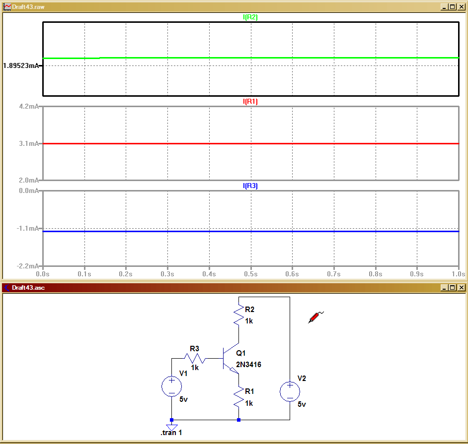

This is what LTspice shows..
Exactly, how does I(R3) turn out to be 1.19 mA ? Cause if we apply KVL on the input side and having Beta=100(I hope am right here), I(R3) should be 42 microAmp.

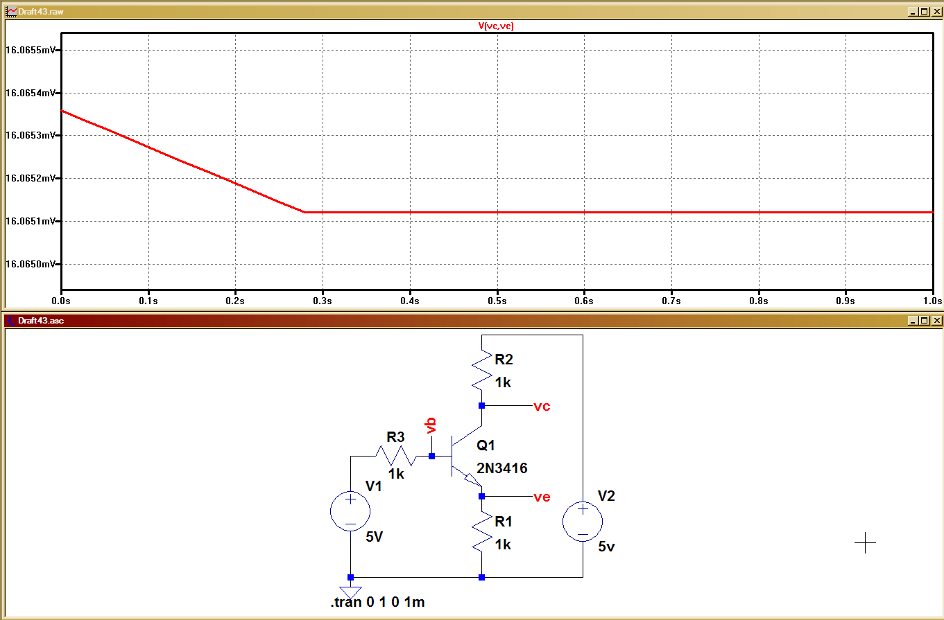

As its homework we do not give a direct answer, try this ,,, reduce the Vinput to say 2V and the see what the Ibase measures..
Hint: has your class work covered transistors in saturation ????
EDIT:
Look at this LTS plot note the Vce, the transistor is saturated.

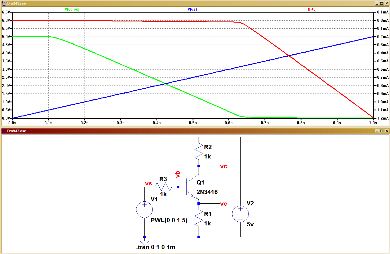

This Sim shows whats happening to the Ib as the Vce falls

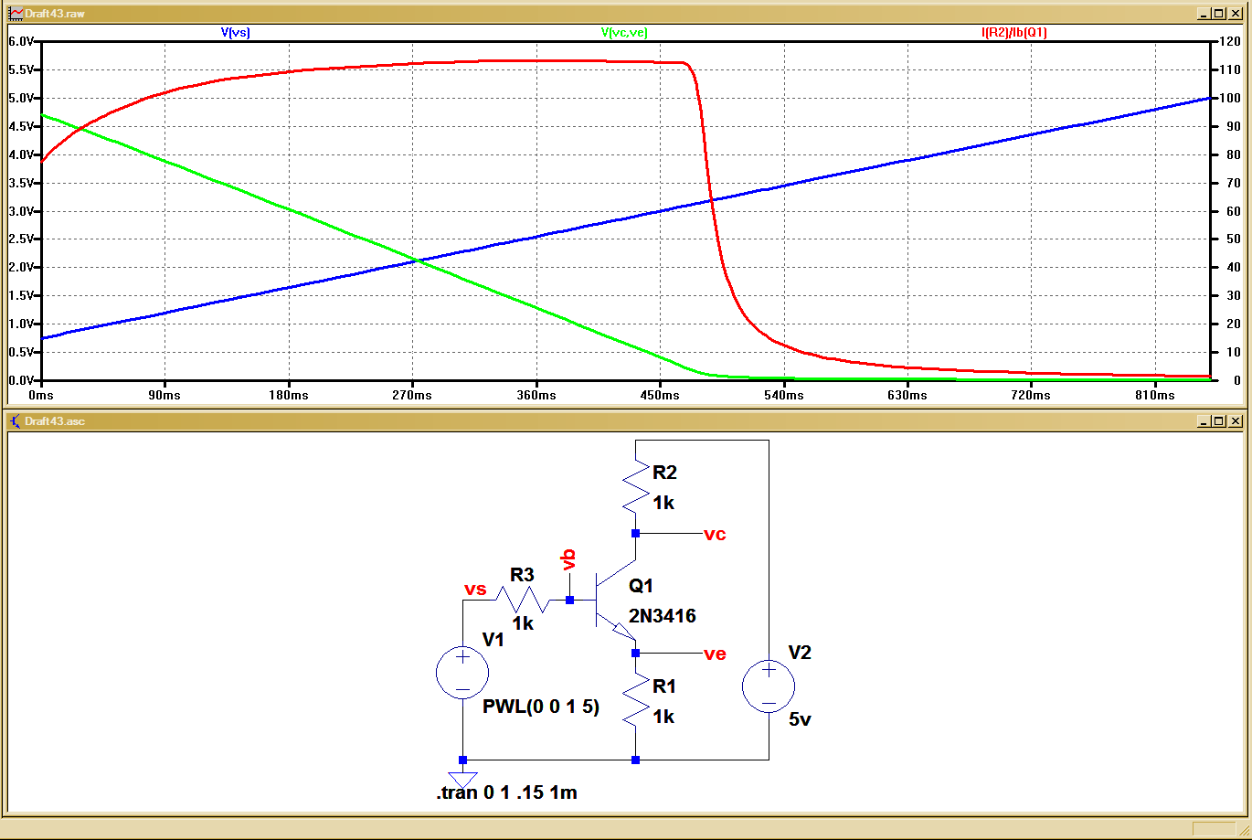

Look at this image, see the RED line showing how the gain falls off at saturation.
