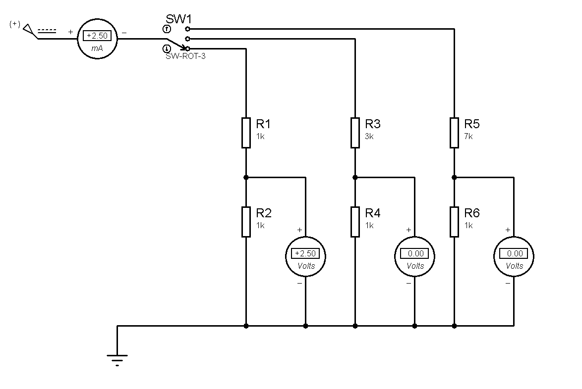

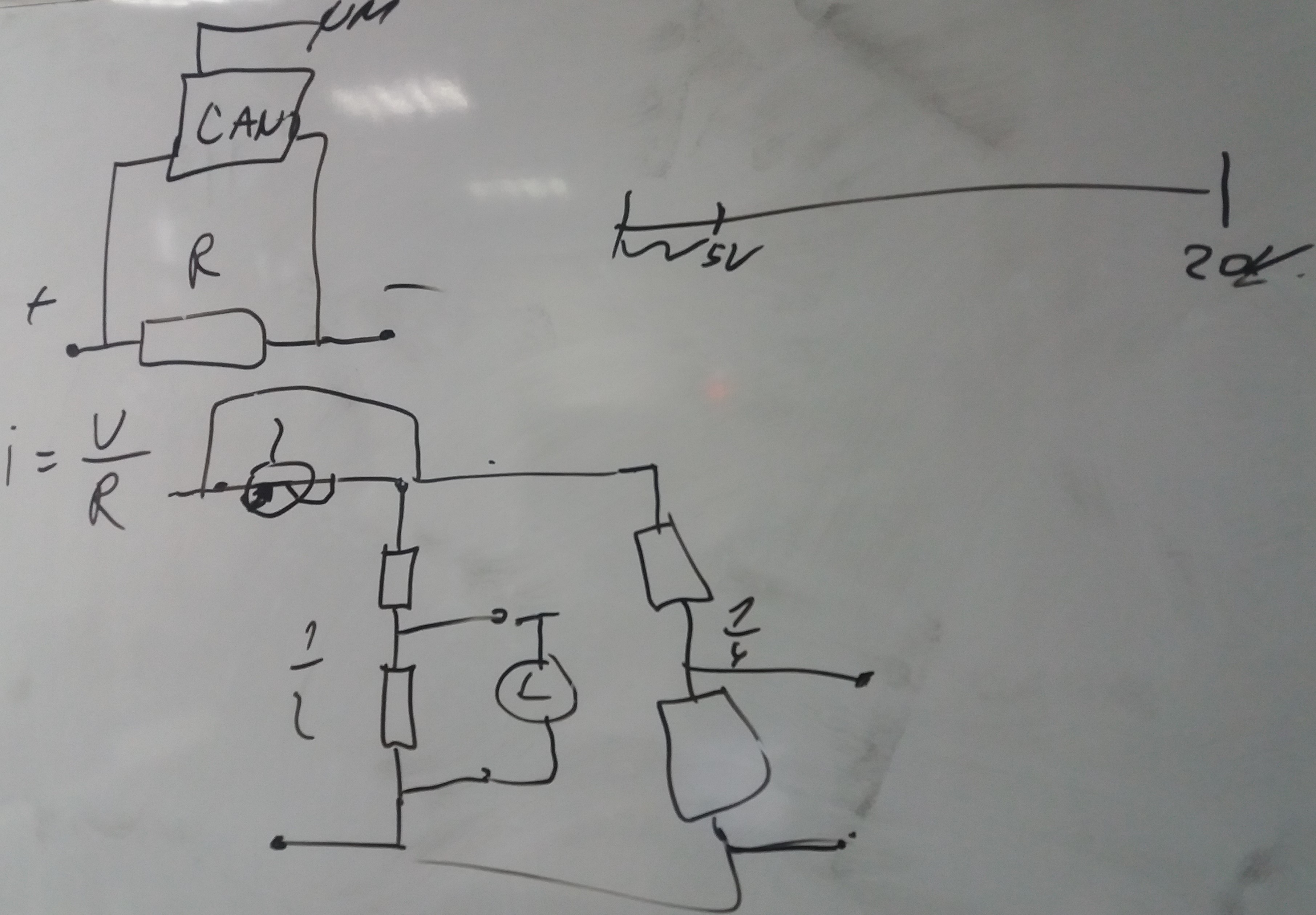

Hi, I have to do the drawings in the drawing in Proteus, but I do not succeed, I do not understand something. You can help me.Thanks.

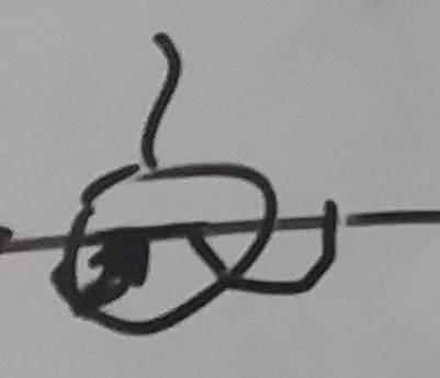

Wow... A bit of a mess.... I doubt anyone can help on this information.. You are going to have to do the drawings in paint then explain some of your symbols... I don't recognise them..

From what I remember it was a transistor, but he said we could use buttons more easily
Er! I think you have tried to copy the circuit from memory!

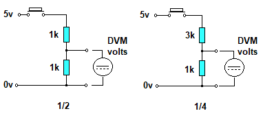

Is this what's required?
Then the current in the "voltage divider" will differ from circuit to circuit... Hence so will the voltage... To get 5V from 20 and keep the same ratio's you'll need a regulator or at least a Zener!
