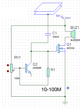

Zach,
I could not make the previous circuit work with enough sensitivity, so I decided to modify it some more. This time using a wallwart transformer I got so much sensitivity that I had to decrease R1 from 100M to 10M. It would go on the moment I connected my croc-clip onto C1. Waving my hand now close over the sensor plate makes it switch on and off. Touching, switches it on bright (also used LED for testing). You really need RV1 to be a pot so you can set it to where the LED (buzzer) just want to turn on.

COOL!! :lol: i got a pot like u sed and made the circuit and it works great!!
the next thing that im gonna do is amplify it so that i am able to trigger the LED from a couple feet away. i might need help with that, but i want to try and figure it out myself.
one question though: wut exactly does the 2n3904 do? i understand the rest of the circuit, but cant quite figure out the purpose of the 2n3904.
Zach,
I am glad you got it working. The 2N3904.. well this is special and in a follow up post when I have some time will explain the importance of this, maybe with the aid of some theory and diagrams.

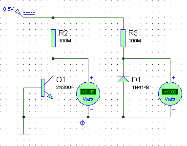

As promised, here is the explanation.
Looking at the first set of diagrams, set up to represent our switch. The 60Hz is the signal we get from our hand induced into the gate through the capacitor. I have used a diode instead of the transistor just to illustrate. The 0V reference line on the scope display for each Chan is marked with a short yellow line.
In the first diagram you can see that the waveform swing +ve and -ve. The overall average voltage level over a number of cycles will be zero. This signal is coupled through the cap and is the same on the other side. The 100M represent the high impedance of the gate input. To switch on our gate we will want an average signal that is +ve at least.
The next diagram shows the same arrangement with the diode in place. Note how the signal after the cap is now DC-shifted "DC restored" upwards, giving us an overall +ve signal on the gate of the MOSFET. In the switch circuit we pushed the waveform up with reference to the +ve gate voltage setting (cause the anode or base is at this potensial) instead of GND as in the example).
Next the question of why I used the 2N3904 as a diode. Look at the next diagram. Here we have 0.5V applied to both a 2N3904 b-c (diode) and a common 1N4148 signal diode. Both are reversed biased (meaning, no current should flow). The truth is that there will be a very tiny leakage current that will flow. Because our circuit rely on very high impedances for the switching sensitivity, we would like to reduce leakage current as far as possible. The meter's resistance was made very high (> 1000M) in the simulation as not to influence the overall leakage by much. You can see that due to the reverse leakage of the diode we have lost almost all (96%) of the voltage while with the transistor-diode only a small (10%) part.
Hope you understand all this. Told you it was a special diode :D
