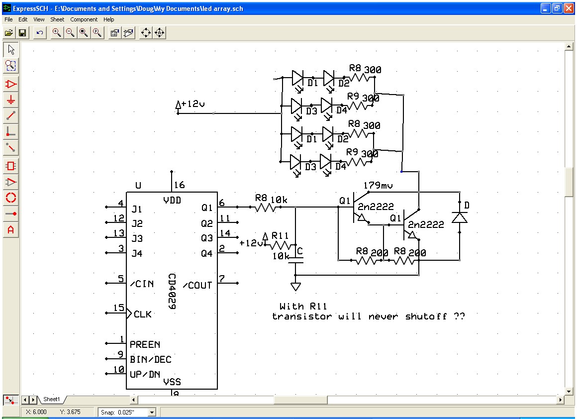

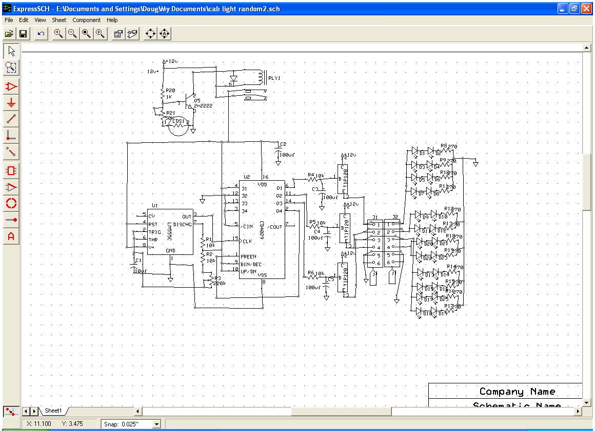

proper transistor circuit??
ran a simulation of this circuit in TINA and it looks like it will work??
transistor is saturated??
Was contemplating using mosfets but with only 53ma draw why reinvent the wheel (I got lost reading how tos of mosfets)
going with relay or larger transistor for powering my random cabinet light circuit (see post)

Per your original,
Orginal circuit using the 2n2222 or 3904 transistors on the cd4029 outputs or the relay?
Remember: a silicon NPN with a grounded emitter will have a base voltage of .7 if turned on hard.
Audioguru suggested using a darlington transistor (TIP120) which kinda makes sense as I have a low current output from the 4029 and the load of the led array (per 8 is calculated at 53ma)
The darlington transistor will/ should do the job.
The load will be connected to the emitter not the collector (pretty sure this is what audioguru is refering to.
see my schematic

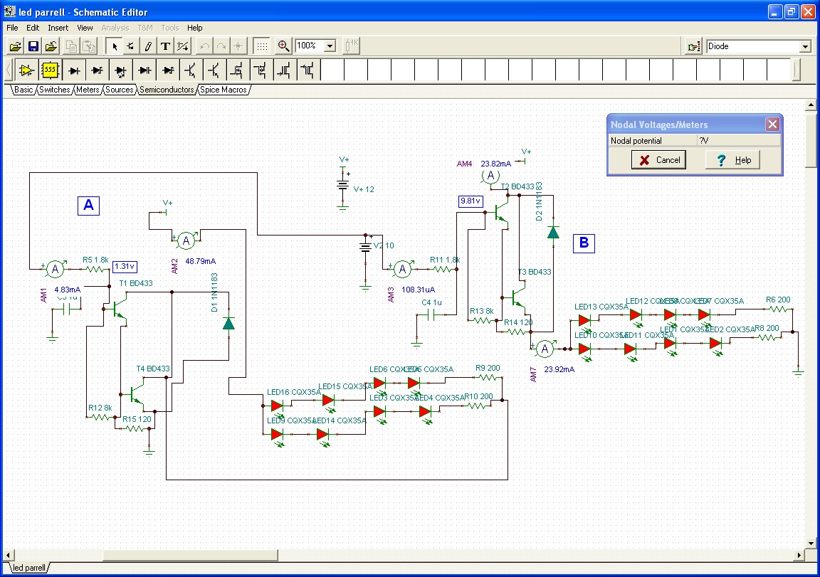

TINA simulation of darlington
I simulated one circuit w/ load connected to the collector and another connected to the emitter.
reall different current draws.
The base voltages on the first transistor are really different as well.
looks like the collector / load connections are best??

Don't you want the LEDs to slowly brighten and slowly fade? Then the LEDs should be at the emitter of the darlington transistor, the base resistor should be 10k and the base capacitor should be 100uF.
You have a 1.8k resistor feeding a 1uF capacitor that have a time constant of only 1.8ms. A 10k resistor feeding a 100uF capacitor have a nice slow time constant of 1 second.
Your simulator is giving odd voltages and currents:
1) You have 4 LEDs in series then their forward voltage is only 1.5V?? A red LED is 1.8V to 2.0V and blue and new bright green LEDs are 3.0V to 3.6V.
2) The simulation shows a very high base current for the darlington transistors that you made becaude a BD433 has much less current gain than a proper darlington transistor.
The LEDs will not brighten and fade if you use 4 LEDs in series. Use one or two LEDs in series instead.

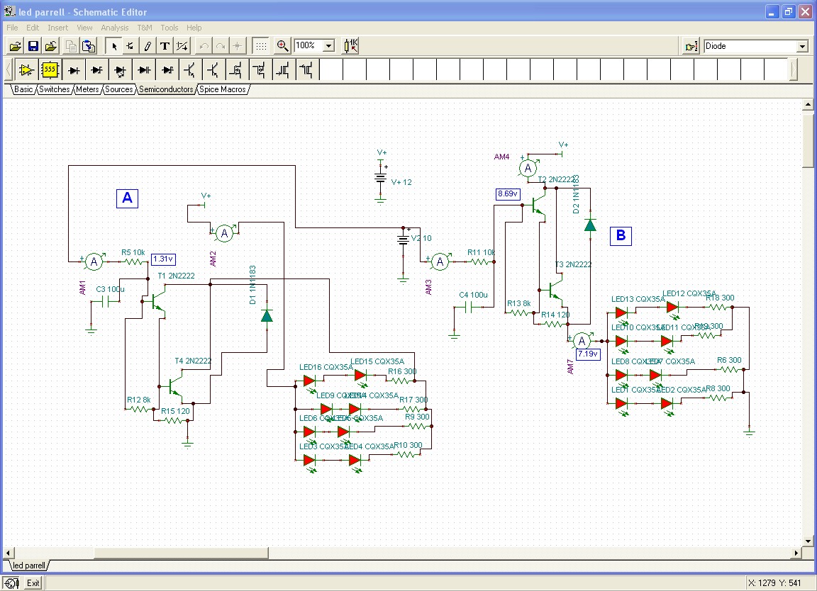

forgot to make changes
The darlington transistors I put in the simulation were just that, used what TINA has which is no darlington transistors.
I was just curious.
As for the caps and resistors I failed to change out.
Will redo the led arrays with only 2 leds per series.
will repost with corrections
Thanks for your input

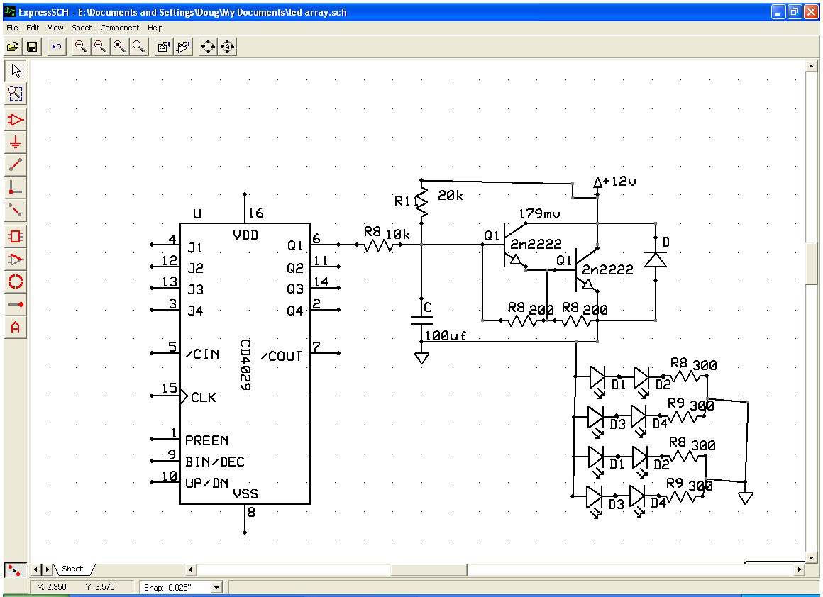

changed the resistors etc
Just outa curiosity I put 2n2222 transistors in the darlington pairs.
Put 300 ohm resistors on leds after I put in pairs.
Planning on the suggested TIP120 darlingtons.
Need to look at relay circuit more

Your latest simulation with 2n2222 transistors shows no currents.
You don't say what is the forward voltage of your LEDs (which I think is too low) so I can't calculate the current.
I think the simulator is too stupid to slowly brighten and fade the LEDs. It shows the 100uf capacitors fully charged all the time.

I don't know why you bought LEDs with such a narrow viewing angle.
If the LEDs are 3.8V each then the total for two is 7.6V. The output high of the CD4029 is about 11.6V when it is powered from 12V and is loaded with a darlington transistor that has low current. The 10k resistor will have low current so will have a voltage drop of 0.3V so the max base voltage of the darlington is 11.3V and its emitter is 10.05V. Then the 300 ohm current-limiting resistor has only 2.45V across it and a current of only 8mA in it and in the LEDs.
If the two LEDs are 3V each then their current will be 13.5mA.
The LEDs will need to have their forward voltages measured and have a current-limiting resistor value calculated for them.

The original circuit uses single LEDs that are probably 2V red ones.
Your LEDs have a fairly high voltage and two are in series. So I think your LEDs will spend most of the time fully dimmed and will begin turning on and brightening when the capacitor voltage exceeds 6V or 7V.
An extra 10k resistor from the capacitor to the positive supply will keep the voltage of the capacitor from dropping too low which turns off the LEDs.

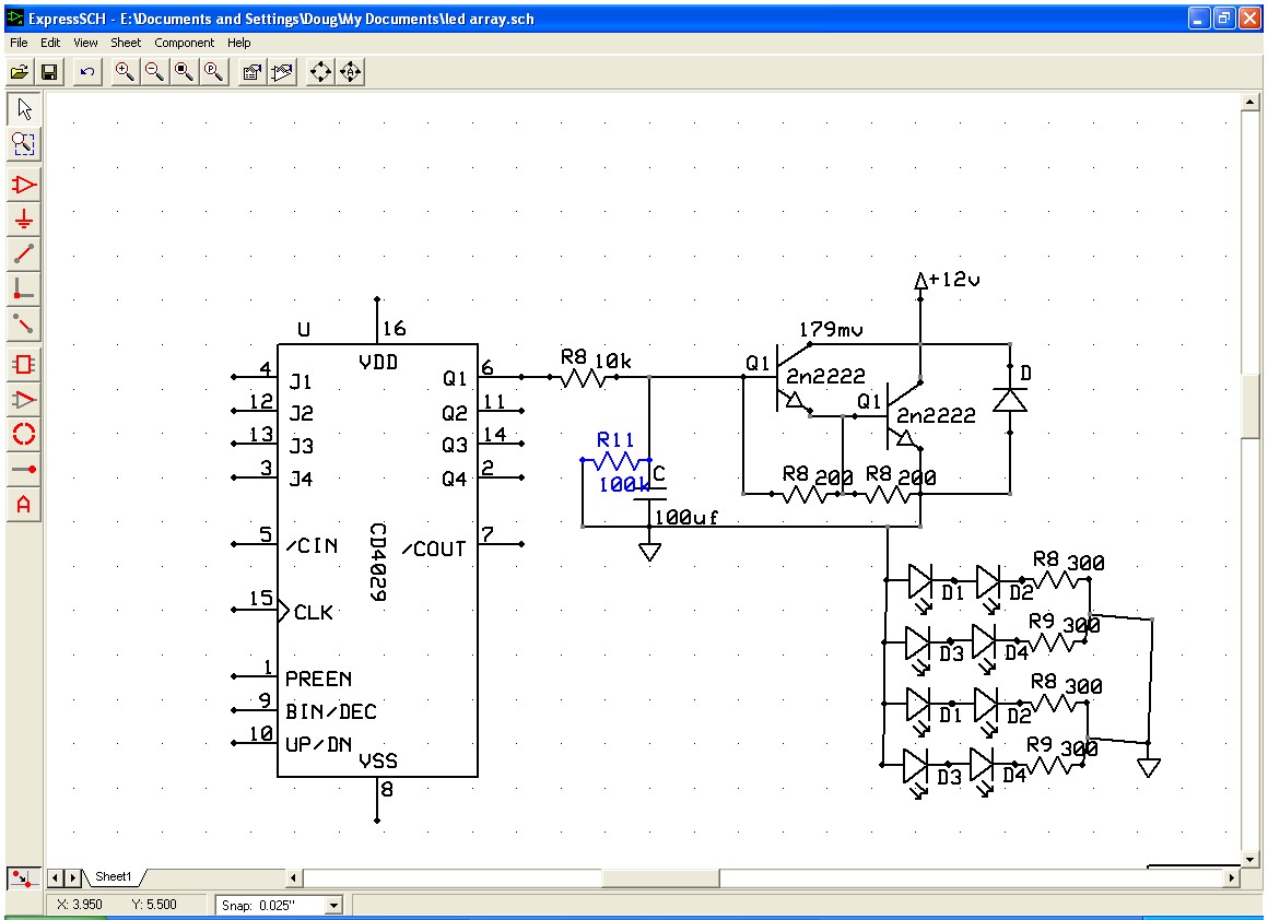

Now I'm confussed???
If I connect a 10k resistor to the capictor that is going to ground then connect to the 12 supply??
the transistor won't shut off will it???
I'm thinking the resistor goes to ground and the cap connects to the 4029 output??

I screwed up on drawing
I messed up on the privious post.
The led arrays are supposed to be connected to the emitter not the collector (for dimming effect).
I changed the resistor/cap setup.
I THINK this will make the transistor switch off slowly for a fading effect??

Didn't you see my last post?
The LEDs need 6V to 7V before they begin to light.
But the capacitor starts charging slowly when its voltage is 0V and takes a long time to reach 6V or 7V so the LEDs will be turned off for most of the time.
If a 10k to 22k resistor is added from the capacitor to 12V then the LEDs will begin brightening almost immediately after the output of the CD4029 goes high. When the output of the CD4029 goes low then the LEDs will dim.

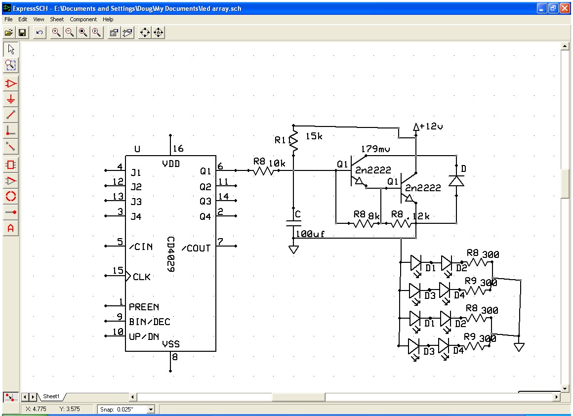

Your R8 is only 200 ohms which is like a dead short to the circuit.
R8 in a TIP120 darlington is 8000 ohms, 40 times higher with only 1/40th the current.
When the output of the CD4029 is low then the voltage divider of the 20k and 10k resistors make the capacitor have a minimum of 4V. When the output of the CD4029 goes high then the LEDs will soon begin to turn on and brighten. The 20k resistor should be 12k to 15k when the LEDs have a total forward voltage of 6V.
oups again
R8 was what the last componet was in TINA. Forgot to change as per TIP120 data sheet (I plan on using the TIP120 instead of constructing my own darlington pair.
I changed the 20K to 15K
