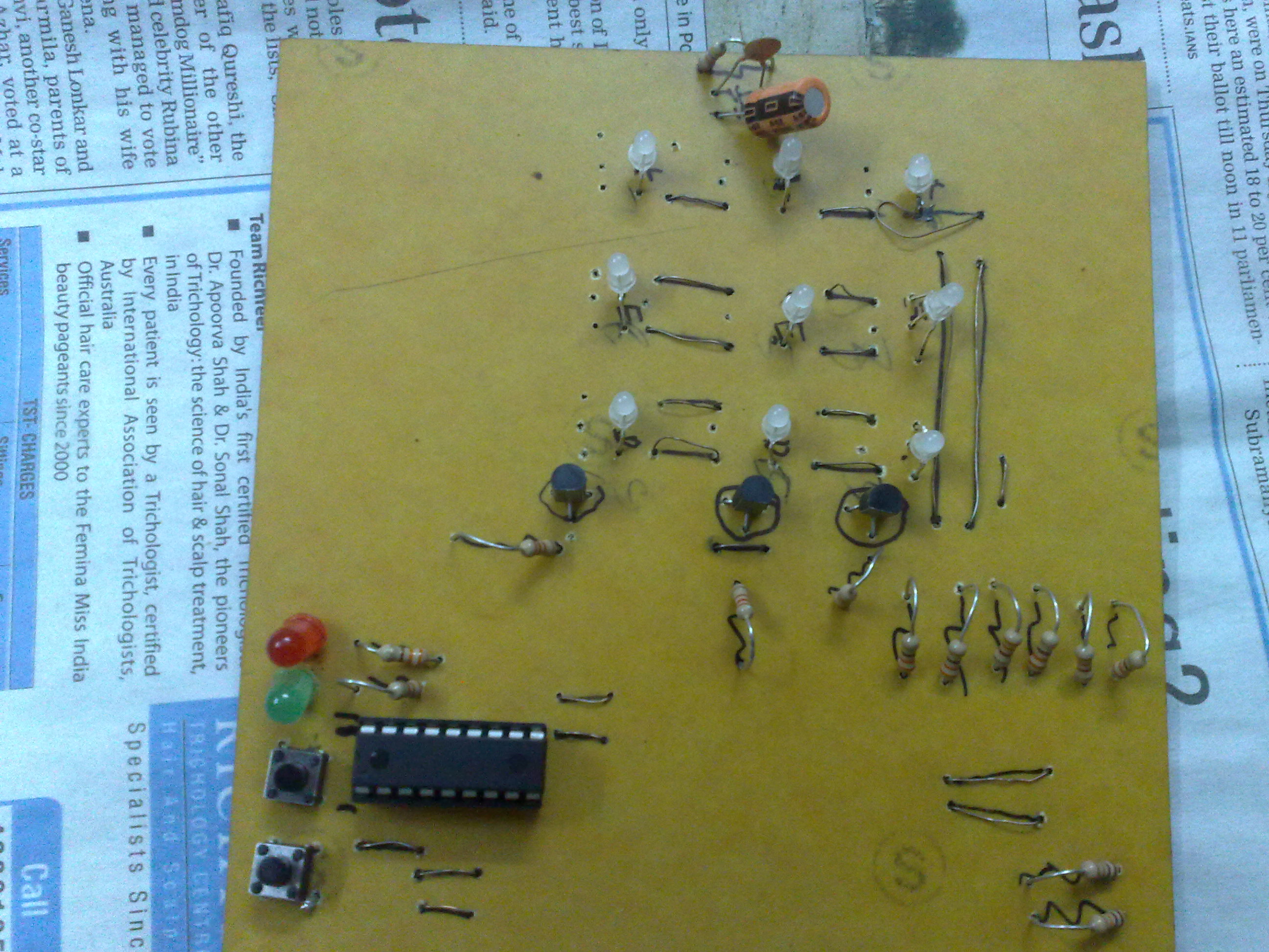

I have just spent some time in the chat talking to synchronus about this. Apparently he got a chip burnt by a store and does not have a programmer to verify it. Now the circuit "doesn't work".
He left the diode out of the circuit because someone told him it would make problems. I do not know what she/he replaced it with instead, if anything.
I have suggested that she/he takes pictures of the circuit and posts them on here for us to see. I also suggest that she/he takes a voltage reading at pin 14 of the PIC (+V) to see if it has power.

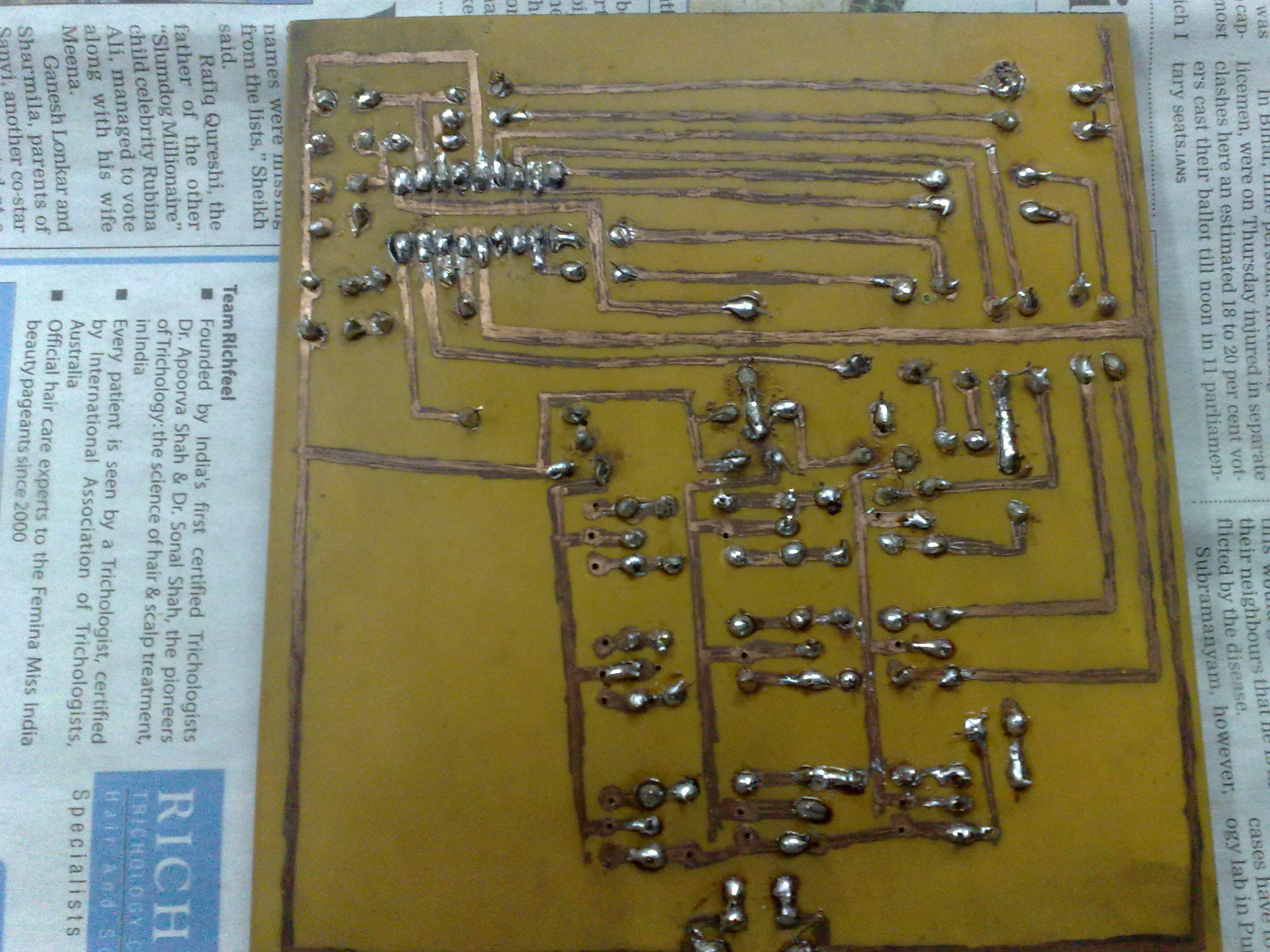

hay i have attached pic for my board check it out.

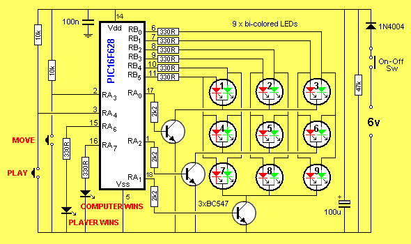

You haven't added the jumpers across the underside of the board. You haven't put a 100n across the chip.

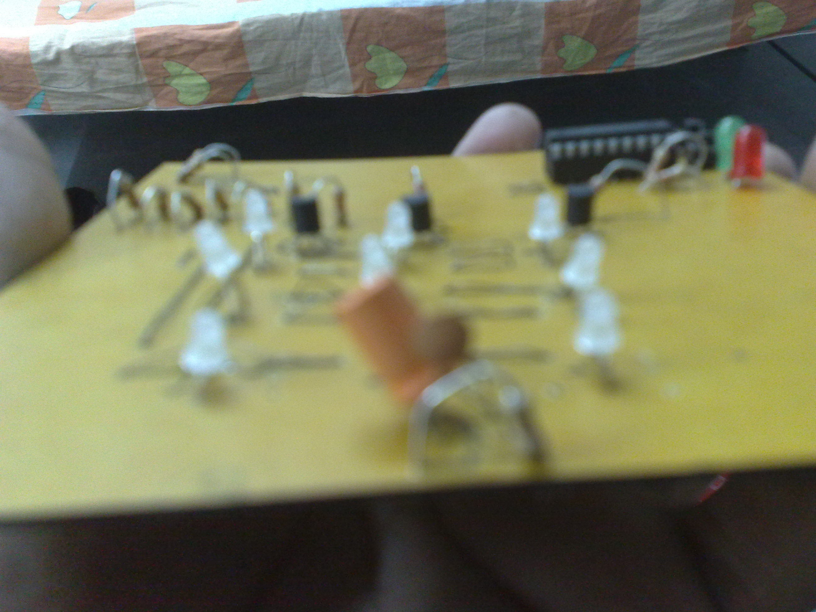

hay colin thats there .. i had put the 100n capacitor across battery,parallel to 100 micro n resistance.. u can better see in these pics too
Yes. You put 100n across the battery but not across the chip. No jumpers and no diode to reduce the voltage to less than 5.4v
with refrence to the above photo i guess theres only one 100n u need.. and that too position among battery terminal
