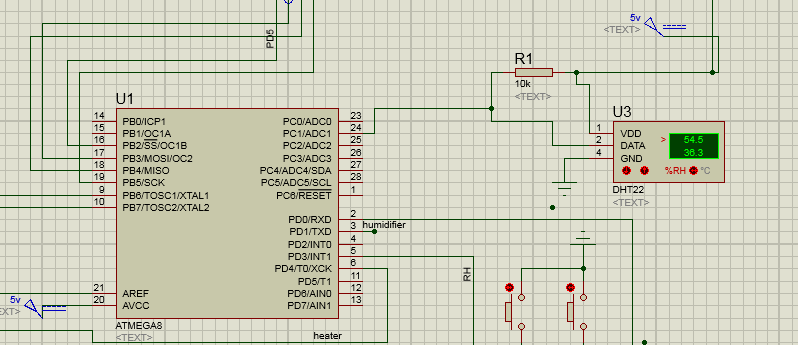

in simulation, it displays 1.245 % , when i change the humidity it change the tenths numbers and the full scale reading doesn't pass 2%
So do it properly, why would you imagine simulation is of any use?.
Sometimes it's easier to get the software right first.
That said... Show your schematic.... If you are using ISIS you will probably have the wrong resistor primitive...
yes, i am using ISIS, resistor is 10 kohm connected as datasheet
do you mean that analog port can cause issues with this sensor?
note: i was working with dht11 which suddenly stopped working properly and read high or low value and stuck there, could that be the reason
I wish you would reveal the whole story.. Dribs and drabs of information isn't very helpful.
ISIS simulates noise and a 10k will produce noise ( more than for real ) You can of course remove transients from simulation, but why!! If you just used digital resistor primitives it'll make it simpler..

Software simulation doesn't just stop working... Something must have changed.. I was looking at the Arduino library for these things and the code is the same..
I used digital resistors because they work better in digital simulation... The models may be slightly different, they may have higher impedance or slightly differing registers... I haven't written code for this device so I cannot say...
