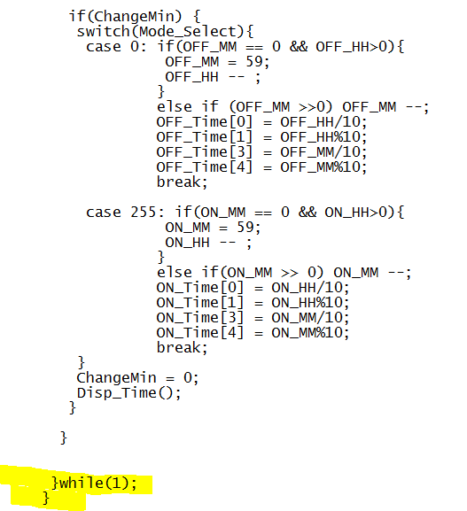

Hello, can someone to rewrite the code for this controller, so the timer to be cyclic(repeating ON-OFF-ON-OFF)?
Тhanks in advance!

Here is OP's code, but I don't code in C
Max.
* Project name: Programmable Digital Timer
* Copyright:
     (c) Rajendra Bhatt, 2010.

Has anyone taken a closer look at this program? I noticed the author used a 4-MHz crystal instead of the 4-MHz internal oscillator but he didn't really take advantage of it to improve timing accuracy. That is, he uses TMR0 and prescaler for time-keeping in a way that isn't very accurate. What was he thinking?

I'm curious how others might develop accurate 1/2-second and 1-minute flags with the resources available on the '628A? I'm still thinking about re-writing this program in XC8.
Happy Holidays, Mike
It only just fits when compiled with the pro version.... The ISR variables need to be declared volatile or the "Blink" variable doesn't work... It was quite a task... I did it after I read the first post ... I have no idea how mikroe gets functions working with both const and ram pointers...
