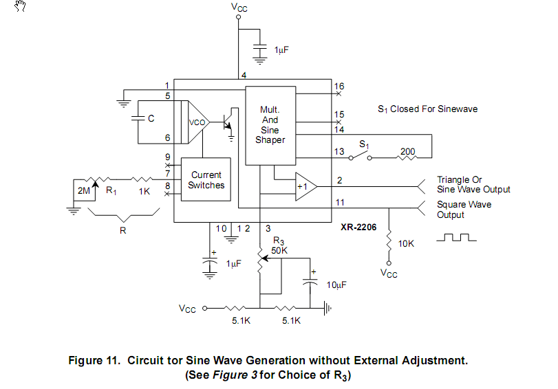

Finally after almost a month of waiting for it my XR 2206 has arrived.
I went to test it on a breadboard.
I connected everything as on the circuit in figure 11 in the datasheet, with the minor difference that the pot at R1 is 1MΩ instead of 2MΩ.
I pre-setted both pots in the circuit to max values.
I checked all connections with an ohm meter.
I double checked connections on the breadboard and in the diagram in the
figure 11.
I chose a low test voltage (12V) close to the minimum specified in the datasheet.
I hooked the output to the scope over a 1/10 probe.
I placed my finger on the IC (first hand temp control :D) and turned on the power supply.
Nothing happened, no sings of life at all (i checked all time basses and amplitudes).
Than i tried to see what happens if i move the pot at R3 (for setting ramp/sine, btw i need sine output).
Nothing happens over the entire range of the pot, still completely dead.
I returned R3 pot to its starting position and tried moving the R1 pot (for freq adjust).
Nothing happens, but when the pot reaches about half of its range (~500kΩ) the IC suddenly gets vary hot, so hot i cant keep my finger on it anymore.
Than immediately turned of the power supply.
I triple checked all the connections on the board and on the diagram. No mistake there, at least none i can see.
But result is always the same, the IC heats up fast and plenty when the pot at R1 reaches about half of its value.
WHAT IS GOING ON ? :confused:

The datasheet assumes it is on a small pcb and a supply bypass capacitor is there (1uF to ground at pin 4).
What is the value of the frequency determining capacitor between pin 5 and pin 6?

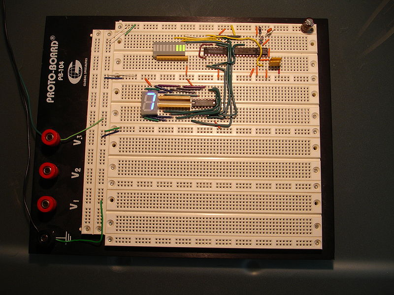

Considering breadboards i only have one type available. It is this breadboard only from a different manufacturer. This is not a photo of my breadboard,
it is only a pic i found online so i can show you which breadboard type i'm using.

Fig 11, shows two 5K1 resistors forming a divider chain from +V to 0V
with R3 connected to the junction of the divider.
Also on the divider junction is a polarised capacitor.
Is the capacitor the correct way around.????
What is the measured voltage at the junction of the 5K1 divider.???? Tell us.!

Did you measure the voltage on wiper of R3. What voltage did you measure?
Voltage between the two 5.1k resistors is 5.6V.

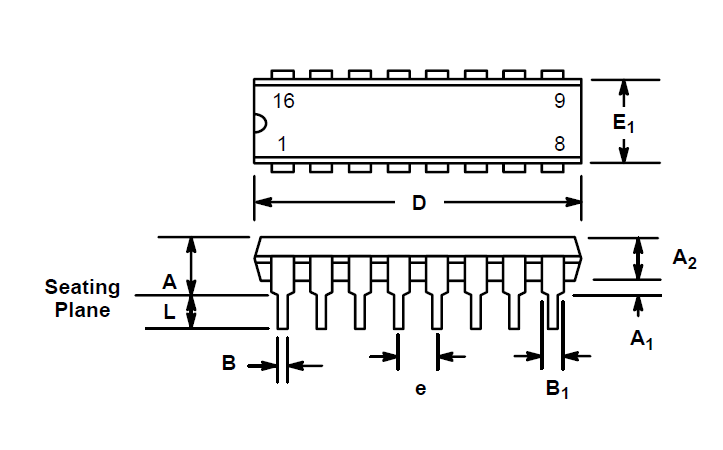

In the datasheet there is a dot on pin 1 and there is a dot on the IC as well. So i thought that was the pin1. Actually that dot isn't the marking for pin 1, i don't know why is it there at all. Pin 1 is the left side of the little half moon dip on the opposite side of the IC. Well i had the IC reversely connected 180 degrees, no wonder it didnt work and only heated. I connected it correctly now but only response i get is a Differentiator response when i turn the pot at pin 3.
I think its fryed due to gnd and vcc pins changing place (pins 4 & 12).
Why is that dot there on the oposite side of the half moon dip?
The notch on a dip chip is the thing to look for. Ignore the dots.
The pins are clearly marked in the datasheet:
