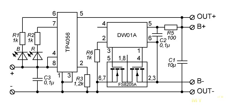

Hi all,
I am designing a circuit that runs on a single rechargeable lithium ion polymer battery. The battery does not come with any inbuilt battery protection circuit so I implement my own protection circuit based on S-8261. I followed the same exact design in my application:
The battery is connected to VDD and VSS of the S-8261. And I am using EB+ and EB- as the VCC and GND of my circuit. I also have a 3.3V LDO voltage regulator connected to EB+ and EB-.
The problem I am facing now is that when the battery is connected, there is no voltage on EB+ and EB-. Only when I short circuit battery negative terminal to EB- momentarily , then everything will start working normally. I can remove the short circuit and there is a voltage across EB+ and EB-. I don't know what is the cause of it. Can anyone help or advise?

I recently built a circuit using the same charger but with a boost regulator for the output. The battery I used was a 1AH Lipo from Sparkfun. The battery has built in protection to stop over discharging. I posted the schematic in this thread - is yours similar?

The board and circuit I posted is for unprotected LiPo's - either use the small boards, or copy it to your own PCB :D
But if I followed the reference design, it should work! But it isn't. Is there any way to troubleshoot this?
The pin numbers on the dual FET seem to be different to those on the circuit I posted, you might like to check which is correct.
You're also a little hopeful if you think that datasheets are always correct!.
