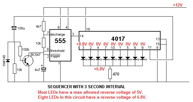

Looking at the "typical" current curve on the Texas instruments datasheet for the CD4017, with a 12V supply, 2V red LEDs and a 470 ohm current-limiting resistor the current is 14.5mA. Then the cathodes of the LEDs that are turned off are +6.8V as a reverse voltage. the max allowed reverse voltage for most LEDs is only 5V.

When the first output is HIGH, the first LED is illuminated. The output pin will have about 11v on it for a 12v supply. The cathode of the first LED will have approx 9v on it and this means 9v will be across the 470R resistors.
The second output will be LOW and the anode of the second LED will be at 0v. The cathode of the second LED is connected to the same 470R as the first LED and it will see 9v.
This 9v is in the opposite direction to a voltage that normally illuminates a LED. This reverse voltage may be too high for the LED.
The solution is to use separate voltage-dropper resistors for each LED.

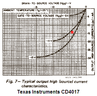

The datasheet of the CD4017 from Texas Instruments shows a graph of the typical current.
With a 12V supply and a 1V drop the current is only 4mA, not (9V/470=) 19.1mA.
The output will be 8.8V as I showed because the output transistor will have a drop of (12V - 8.8V=) 3.2V and the current will be 14.5mA.

The HEF4017BE and CD4017BCE (that I tested at the current flow mentioned in my reply) had an output voltage of 10.5v when the supply was 12v. The output voltage really doesn't matter, the point of my reply was to show the reverse voltage on an unlit LED can be higher than the allowable specification of 5v, and I simply just substantiated a comment made by another poster that this case can exist.
It isn't something I would do, but since we are talking about a novelty item anyway, exceeding the reverse breakdown voltage of an LED will not damage it, in the short term, if the current is limited below some (usually unspecified) level. Using a single resistor may also address the OP's problem where LEDs are dim that are expected to be off. They certainly will not be dim if they are reversed biased. Repeatedly doing this to an LED may have long term effects.

For a supply voltage of 9V and using OSRAM super red LEDs (UF=2.0V, IF=20mA) the values are 220R for two series LEDs and 330R for a single LED.
Using individual resistors on all LEDs being controlled by an NPN transistor there is no problem of possible reverse voltage. Additionally switching ground to the LED there is absolute no chance of false polarity across the LED.
