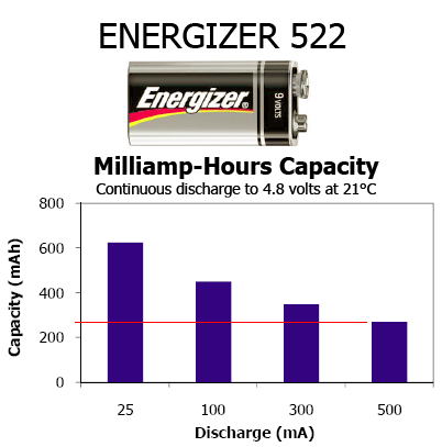

The OP initially wanted to operate the circuit with a 9V/100mA battery, which is definitely too weak.

You say you are an electronics engineer. Show me where you can get a 9V/100mA battery. I want to buy one.
The 9V block battery doesn't have more than 100mA/h.

A battery capacity is not expressed as: "The 9V block battery doesn't have more than 100mA/h."
It is: 100mA-h. or 100mAhr or 100mAh There is a big difference.

Energizer has a datasheet for every battery they sell. They show their 9V alkaline battery with a capacity of 625mAh when the current is 25mA and a capacity of only 280mAh when the current is 500mA. A new one can easily supply 1A or 2A for a few minutes.
Duracell say that the internal impedance of their 9V alkaline battery is 1.7 ohms when new. So it will supply 4.5V at 2.6A.
