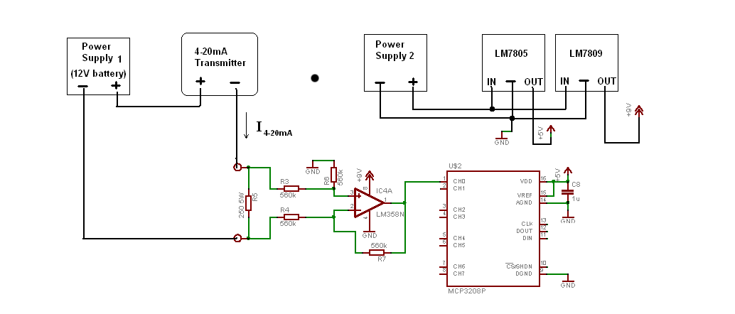

I'm working in a project where I have do read from one 4-20mA output sensor (LU-20 - Flowline LU20 EchoTouch™ Two-Wire Ultrasonic Level Transmitter) by the MCP3208 ADC (using PIC18F2620 and others stuffs also).
I built the signal conditioning circuit by means of LM358 OPAMP with differential inputs (see input.jpg) and one 250 Ohm resistor (to get 0-5V from 4-20mA).
During some tests I applied 0-5V through the 250 Ohm circuit input resistor and everything worked fine and the ADC outputs were as they were supposed to be, but when I put the circuit input (its 250 Ohm resistor) in the 4-20mA sensor closed loop, I noticed that the ADC outputs began to fluctuate around the values they should be.
Even using a single power supply (sensor and circuit in the same supply with same ground for both) or using two power supplies (one for the sensor and another one for the circuit), the ADC output fluctuation still exist.

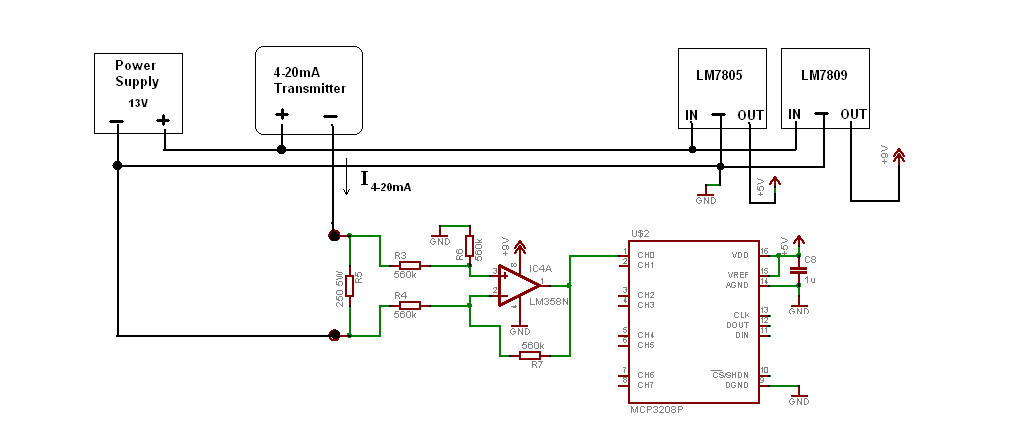

Connections diagram
Tomble, ericgibbs and aljamri, thank you for yours repplies.
Aljamri, it was my fault. I wrote it wrong. I should had written "(to get 1-5V from 4-20mA)". Thank you!
Tomble, I think it can be really the problem, so, as ericgibbs asked, I put the connections diagram so we can check it.
ericgibbs, here they are: two_supplies.png and single_supply.png.
I've also realized some strange behavior:
1 - When I use single supply connection, when I measure the Voltage (circuit GND as measuring reference) at the input pin of the ADC, I get always an apparently constant correct value (as it should be after passing through the OPAMP configuration), even when ADC output is fluctuating.
For example: with 4mA from the sensor, 1V is gotten through the 250 Ohm resistor and also at the ADC input pin;
2 - With two power supplies, the 4-20mA sensor power supply of 12-13V, and the current of 4mA through closed loop, I still get 1V over the 250 Ohm resistor, but I get about 1.64V at the ACD input (reference at circuit GND);
3 - When I use a power supply of 24V for the 4-20mA sensor, for 4mA in the closed loop I still get 1V over the 250 Ohm resistor, but now I get about 2.25V over the ACD input (reference at circuit GND).
4 - The values gotten in cases 2 e 3 seems to be constant at the multimeter (voltage meter), by the ADC outputs fluctuates.
I hope it may give us some direction.

hi Rodrigo
Disconnect the output of the LM358 from the ADC pin#1.
Using an oscilloscope measure the output signal from the LM358 pin#1 to see that it is 'clean' ie: free from electrical noise.
You may see a mains supply related signal at 50/60HZ
Also measure the Vdc levels at the 'top' end of the 250R, with 4mA you should get +1V and also +1V at the output of the LM358.
From what you are describing you have a ground loop noise problem.
Does the two core cable from the 4-20mA transmitter have a screen, if so where is it connected?
Is the body of the transmitter sensor or any lead at the sensor end grounded?

Hi Eric,
Is the cable screen that woven wire shield around that acts as an electrical shield? If yes, then the cable in use doesn't have it.
The only sensor connection is the 2 wire power supply that acts also as the 4-20mA transmitter line. Its body or even any other of its parts aren't grounded.
I'm going use the oscilloscope to check what you said and after that I will told you what I will have found.
Thank you again!
Rodrigo.

Hi ericgibbs,
First of all, thank you for your so valuable hints/tips. You were right.
There was really a 60Hz wave there. So, the problem was solved when I used the one-power-supply connection.
I still can't realize what happen when I do a two-power-supplies connection. Should I get no problem when I do a two-power-supplies connection?
Thank you very much !
Best regards,
Rodrigo

Connection of the PSU and signal lines are very important, try to use a 'star' ground/common connection for the PSU's and signals.
If you go and search www.analog.com for grounding techniques you will find their application notes useful
It could be one of your power supplies [PSU] isnt 'ground' free on the 0V output
