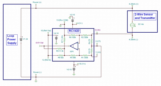

Former Burr Brown has one or two doing the same. And a very nice receiver for the other side of the loop (RCV240).

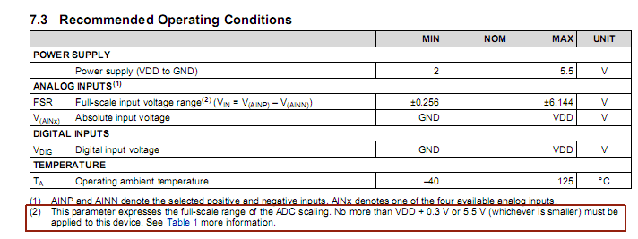

The ADS1015 converter requires an input signal of +/- 6.144v to operate in the 12 bit range.

A quick scan of the ADS datasheet suggests that you have misunderstood the Ain limits.??
The requirement of an amplified single ended signal of +/-6.144v for the ADS input is incorrect.

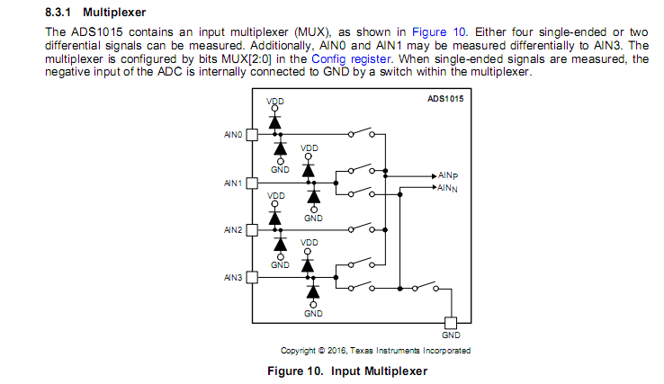

Note the clamping diodes on the Ain inputs to the Mux.
Also Note #2 of Specs.

Eric, I dont understand that data sheet, either. Say Vdd=5V. Then the allowed range of any analog pin is 0V to 5.3V (Vdd+0.3V). If measuring differentially, then V(ainp) could be a max of 5.3V while V(ainn) could be a min of 0V, hence V(ainp)-V(ainn)=+5.3V. How could it ever get to +6.144V?
Unless, the 12bit (4096 steps) range of the AD is from -6.144V to +6.144V, or 3mV per step. Due to the input restriction, only about 5.3/6.144 = 0.86 (86%) of the steps can actually be reached.

but checking the clips of the internal circuitry its shows clamp diodes to 0v and Vdd, which has a Vmax of 5.5V.
So why the OP wants a OPA output span of +/-6.144V doesn't make sense.

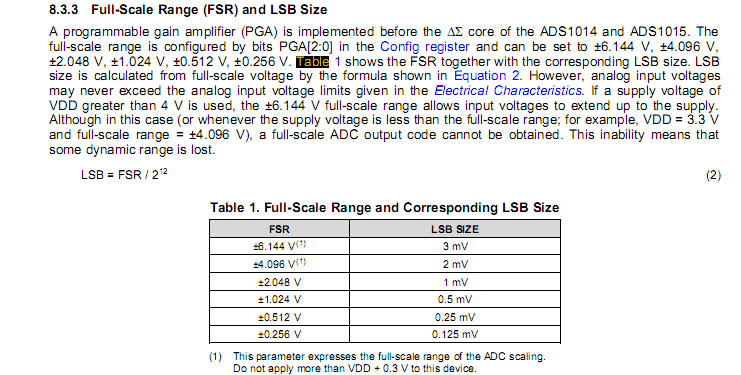

From the d/s Table 1 and the text it explains the +/- 6.144v in more detail.
E
EDIT:
Table 1 shows a resolution of 3mV/bit, so for 4096 bits that is a theoretical range of +/-6.144v,
however the permitted input range is say 0v thru +5v for a Vdd of 5v.
Which I infer as an input of +/-2.5v, that is a limit of +/-833 bits at a 3mV resolution ie: 11 Bits.
You beat me to it... I was also going to post a reference to para 8.3.3
Now CT has to tell us what he really wants to do with it. It says in para 9.1.2 that you can only get half the dynamic range if you use it in the single-ended mode (11 bits), and I cannot see how to create a larger differential signal starting from 4mA to 20mA because the inputs are constrained to be between -0.3V and Vdd+0.3V.
