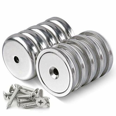

I had an idea for this in the middle of the night:-
If you got a small concentric-pole type solenoid magnet and a "cup" or "pot" style screw fixed magnet with exactly the same outer diameter, the solenoid would just act like a piece of iron when off and the magnet would pull to it.
Power the solenoid with the correct polarity (so the poles repel the magnet) and it would pop the door open.
No moving parts!
You could add a brass shim or rubber pad to space the two apart if the holding pull was too strong.
Examples of the styles of items, though these are much larger than I'd think to be practical - probably 12 to possibly 20mm would be nearer appropriate?
