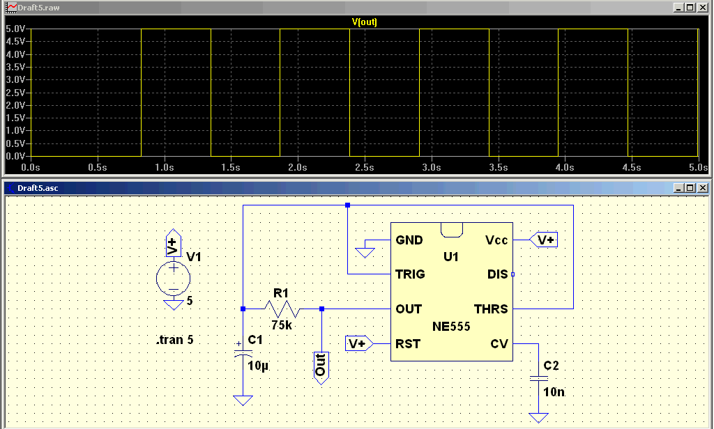

please help with my crossroad traffic light project...
do u know to to this on circuit wizard because i cant find out the option..
I have never used CW.
the simulator is not showing the desired result..
Then try different resistor values! Or use a different simulator :D (LTspice is a free download from Linear Technology).
Try this in your simulator:
Why is the model of your 555 actually a Cmos rail-to-rail 555? The output voltage swing of an ordinary 555 is from about 0.01V to about 3.6V when its supply is 5V and it has no load.
It will cause your circuit to have an output that has pulses, not a perfect square wave.
