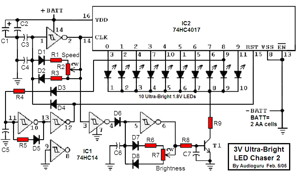

I designed an LED chaser circuit that uses a 74HC4017 high speed and high current counter that works from a 2V to 7V supply. The 74HC4017 works the same as a CD4017 counter.
It begins with the counter reset, the clock low and the LEDs turned off. The reset goes high but the LEDs are still turned off so that the 1st LED (pin 3) does not light then the clock goes high which turns on the LEDs and the 2nd LED (pin 2) lights.
I have it starting with the 2nd LED because it stops after lighting the 9th LED (pin 9) then it looks symmetrical.
After the 10 LEDs have lighted 4 times around and around in a circle, the clock stops, the counter is reset and the LEDs are turned off for a pause. Then after the pause it begins chasing again.
The LEDs have the pause and have a circuit that blinks each LED on for only 15ms so that the battery lasts a long time.
