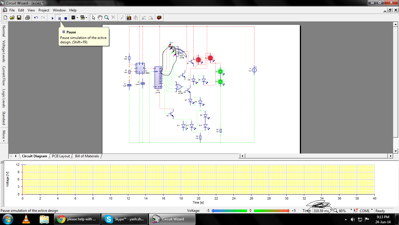

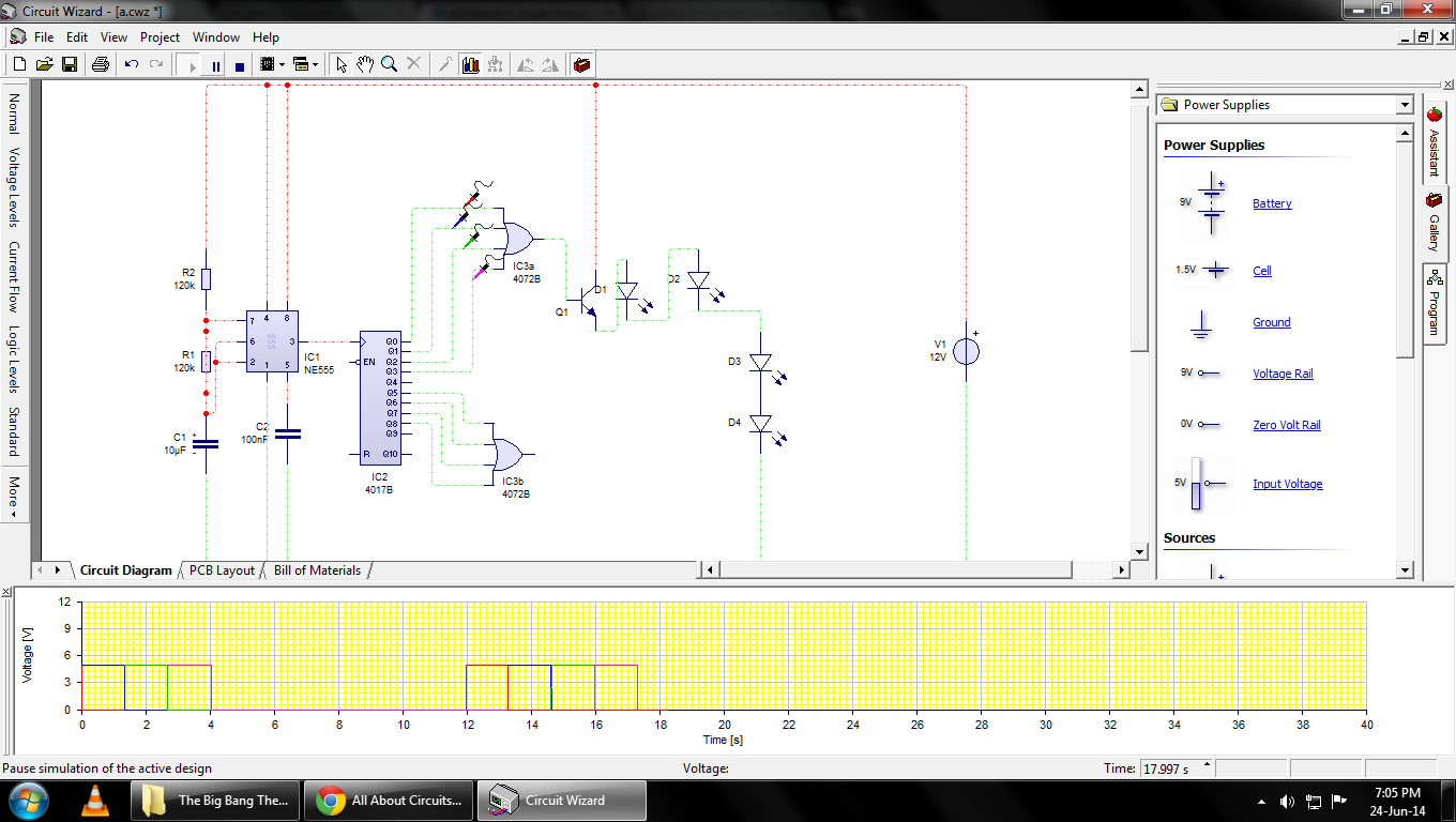

well i finally got the required pulse from the timer ....but now in the counter the pin 0 is not going high in the first loop it goes high int he second loop...please help
First of all you should connect the EN pin to ground. Right now you aren't even enabling the 4017!
so how is it oscillating and connecting it also doesnt solve the problem...
I guess I misunderstood the question. You should still have it connected to ground, and you should have Q9 connected to reset so that it loops without extra delays. This may solve the issue with the LED not turning on "on the first loop". It IS turning on in the first loop, but there is an extra delay when Q9 is on and none of the other pins are. That's why you need to reset the 4017 when Q9 is reached (meaning the light cycle is complete).
why isnt the led turning on what am i doing wrong here...
Didn't you read my post? Connect Q9 to Reset and try again.

what i want is every pin of the deacade counter to go high on every loop for 1 sec ...i.e, any pin form 0-3 should for first 4 sec ...but in the first loop the first pin(pin 0)is not going high but in the next loop it is...

Oh, I see what you're saying now.
Could you post the schematic you're following so that I can get straight which LED is R1, G2, etc?
By the way, I have simulated this myself and I, too, only see Q0 on for a fraction of a second before going to the next output. I'm not sure why this is happening, it may be a SPICE glitch....
