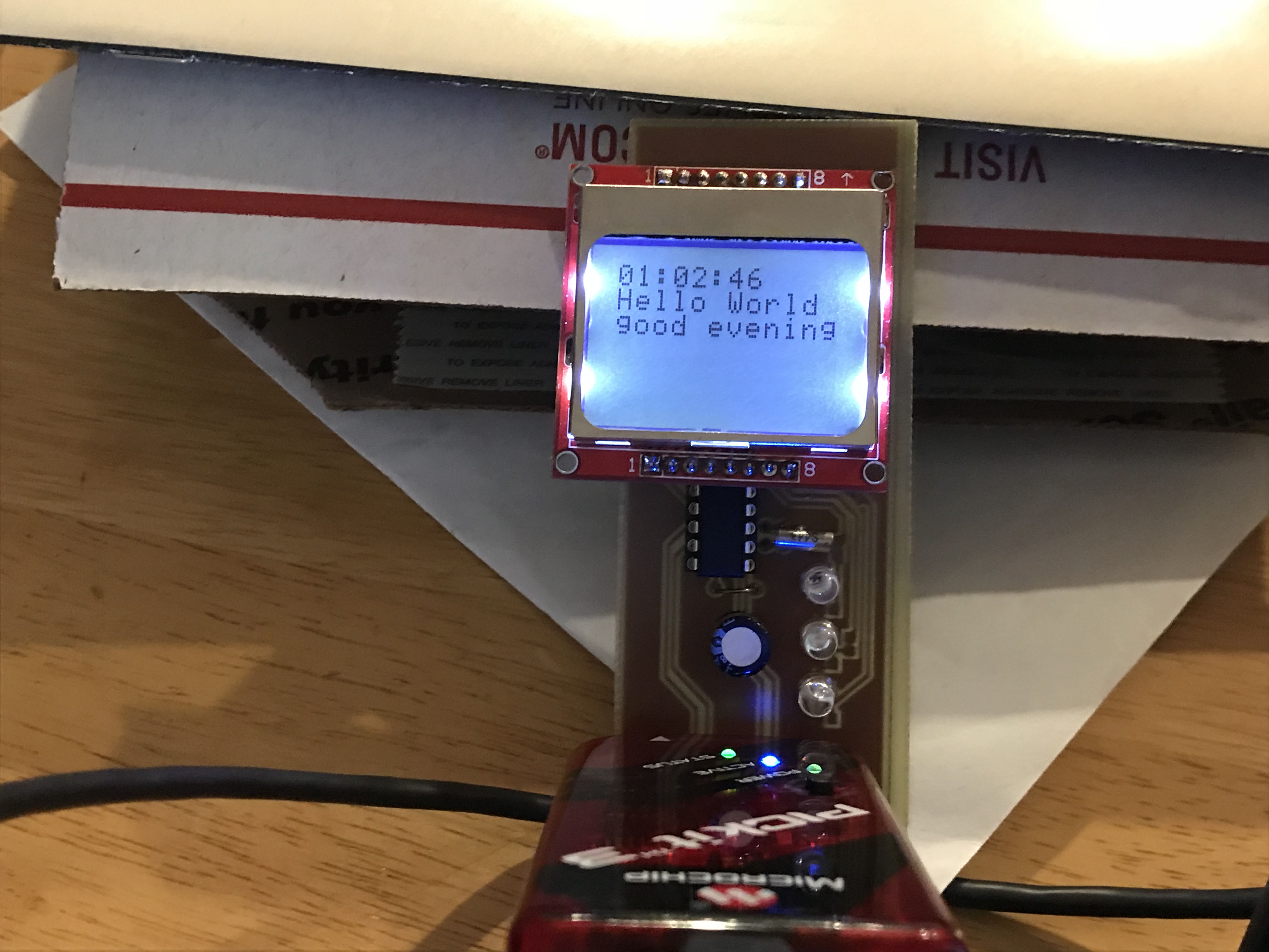

Here is a 5110 set up on a PIC

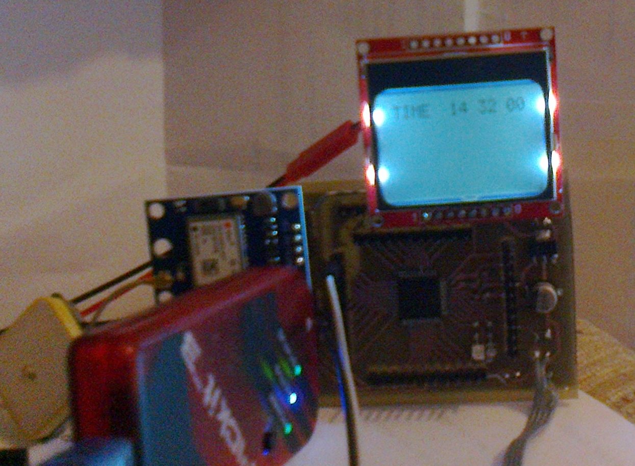

Hi G,
Here is a photo of my 5110 on the PCB with BMP280, GPS and provision for a compass. (Sorry about the quality)
After getting problems with the READings from the full programs (A few posts back) because they were all over the place, I decided to test each of the 3x TEMP BYTE and 3x PRESS BYTE READings individually, to see what they look like. At the moment I'm on TEMP, and so far it looks as though 2x of the BYTEs seem sensitive enough for general use, so TEMP XLSB may not be needed.
As Eric says, joining all three BYTEs (XLSB is 1/2 BYTE) gives a STRING of 20 bits would give the normal way of getting the DATA from the BMP280.
