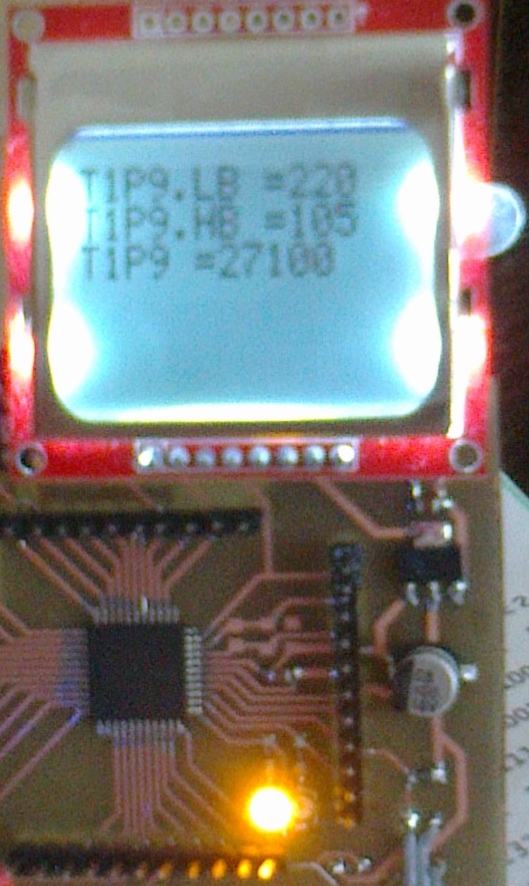

Can someone verify that this program is calculating properly please?
I READ the T1 to P9 inbuilt callibration addresses, and enter them into the calculation, to be printed on the 5110.
First one T1.LB = 220 T1.HB 105 should give T1 = 27100, is this correct.
C
  • 18LF4520 BMP280 5110 CALC T1 to P9 from LB_HB 290118 1030.bas
Hi C,
The two values are OK to give the final answer. 27100

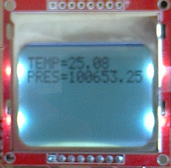

It must be a bug in the PIC-compiler.
It appeared, when program size went over 2048
I installed PIC18 IDE and it works fine.
Calculated pressure 100653.25 Pa
In the datasheet 100653.27 Pa
I will upload the program soon.

Here is the program.
It uses single variables in the calculations.
SPI data should converted to single and take care of the signed integers, which Oshonsoft can't directly do.

Hi J,
Thanks very much for your CALC.
Here is a program using your CALC, which gives the same answer as yours. [Check for my mistakes}
Where did you get the 'adc_t = 519888 and adc_p = 415148' from? and where does a program get them from?
C.
  • 18LF4520 PCB JJW CALC 300118 0915.bas
adc_t, adc_p are test values from the datasheet.
