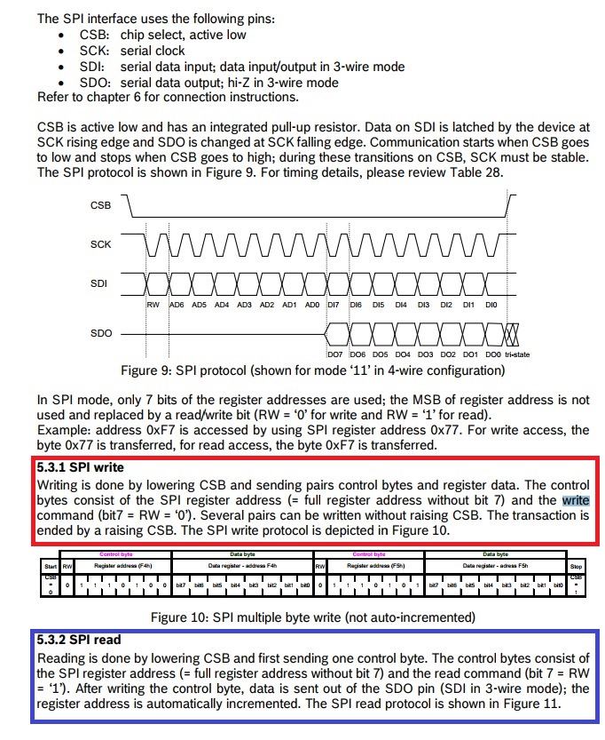

Hi E,
To write to an address, 'say' 0xF4 bit 7 needs to be removed leaving 0x74. See attached in RED:
Note, we spoke about 'burst reading'. In the BLUE box, it says that the register address is incremented. I'll have to read it a few times, to follow.
C.

NOTE: I've yet to find out if CS and SDI and SDO and SCK is 3 wire of 4. It's not clear. (To me anyway)
EDIT: Answer: 4 wire
Thanks.
C.

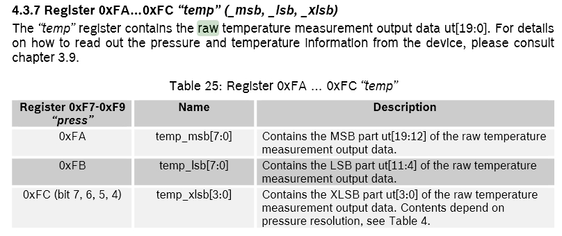

Hi E,
I looked at varous Arduino examples, also the .CCP file, and don't see exactly how it works. There appear to be individual corrections found in the built module addresses also accuracy settings that can be used in the calculation
I'm pretty sure that for RAW READings no calculations are needed at all. See attached. [I only want PRESS reading actually, but as the TEMP appears to give better results, I'm testing that first]
I get the impression that there is something wrong with SPI.
EDIT: Regarding the suspected SPI problem: I think perhaps all of the TEM and PRESS addresses need to be READ at the same time, but not sure
C.

Looking at the attachment in #366.
When I get READings from temp_xlsb I get a range of 004 to 968, which doesn't look correct. It should be the top 1/2 of a BYTE.
Another puzzle: If you look at the attachment it says the result is dependant on the pressure resolution, and also says, in a different section that PRESS can be skipped.
C

hi C,
As I understand the 20 bit value, it is hi byte, mid byte, low byte.... xxxx,xxxx xxxx,xxxx xxxx,0000 lower 4 bits always zero, so a 4 bit right shift is required
E
