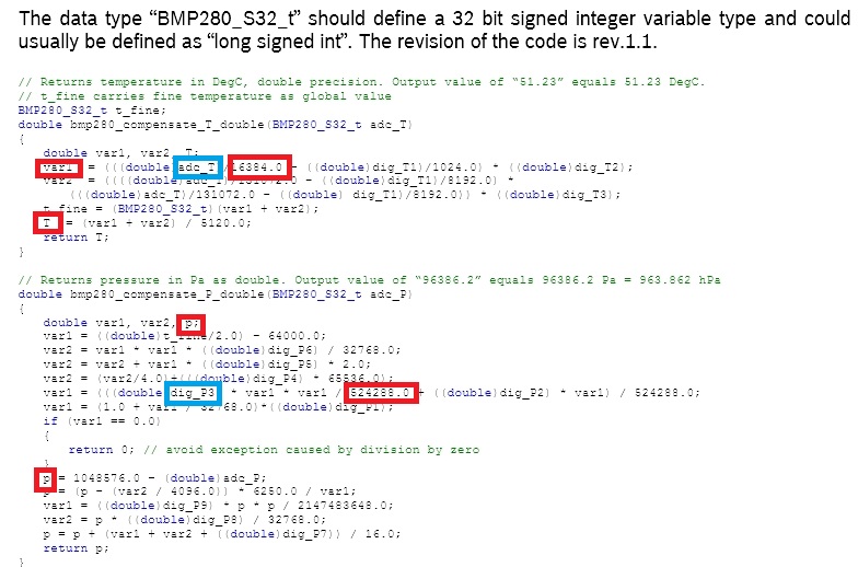

As I'm using 32BIT on pages 45-46 is the line with 64BIT irrelevant?
Looking at the attached image, is it correct that the ones marked RED are LONGs and the ones in Blue BYTES?

DOUBLE is a double precision floating point number ~ 16 digits precision.

Oshonsoft has single precision floating point numbers, ~ 6 digit precision.
You will lose some precision by using singles.
Another problem is that the word and long variables are unsigned integers.

Make all variables as single, except byte arrays b(24), data(8) and SPI registers
Dig_Px - =65536 means Dig_Px = Dig_Px-65536
There are test values in the datasheet, which can be used to test the calculations.
