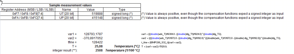

According to the d/s, the Tempr registers are formatted in the same way as the Pressure regs' ie: 20Bit Binary [ which is left Shifted by 4]
You have to do Maths on the Binary value to get the Tempr in Cdeg.

Comparing with what you have to do using Oshonsoft Basic to get accurate values for T and P, with a BMP280.cpp file, IMO it will take ages.
Added this CR LF's to this *.cpp, to *.txt so that you can view with a regular Editor.
E
