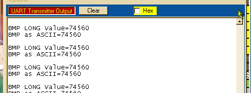

Hi E,
If the image attached is ok, then it is working. I needed to comment out all of the SPI section, for SIM.
Thanks.
C.

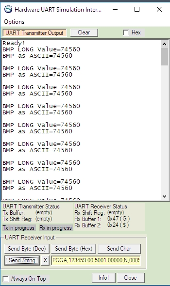

hi C,
I would move the SPIPrepare outside the main loop. say just before the start label.
There is one point which is bugging me, does the LONG need to be right shifted 4 times, as p_xlsb is always zero.
Read the d/s and let me know
E

Hi E,
As expected:)
EDIT: Unimportant: I moved all of the XLSB to the right [p_lsbnxlsb.HB] in the variables.
C

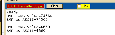

hi C,
I suspect you may have to shift all the value right by 4.??
If so a simple edit.
image shows before and after shift
E

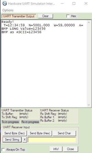

Hi E,
Working in SIM, now shows values=74560 and 4660.
Would you expect this to work with the 5110? The 5110 doesn't start!
C
  • 18LF4520 8MHz X4 5110 GPS BMP280 140118 1300 TEST.bas

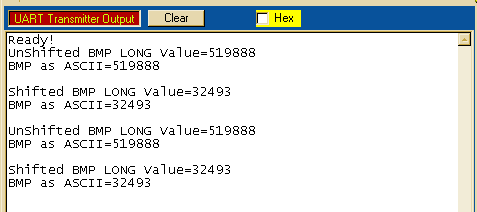

Ensure that the 5110 is initialised.
Have been looking at the BMP d/s, look at this image etc.
E
test1:
'test values from Datasheet
''0x7EED0 [ 20 bit left shifted 4] = 519888 decimal
p_xlsb = 0xd0 '''' NOTE: low nibble always zero
p_lsb = 0xee
p_msb = 0x07
'Join all PRESS bytes as long
p_xlsbnlsb.LB = p_xlsb
p_xlsbnlsb.HB = p_lsb
p_msbnlsbnxlsb.LW = p_xlsbnlsb
p_msbnlsbnxlsb.HW = p_msb
'ascii serial out of bytes,Word Or Single
Hserout "UnShifted BMP LONG Value=", #p_msbnlsbnxlsb, CrLf
msg1 = #p_msbnlsbnxlsb
Hserout "BMP as ASCII=", msg1, CrLf, CrLf
p_msbnlsbnxlsb = ShiftRight(p_msbnlsbnxlsb, 4)
Hserout "Shifted BMP LONG Value=", #p_msbnlsbnxlsb, CrLf

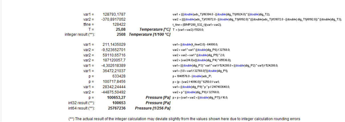

hi C,
Have you seen the corrective maths calculations required to get a pressure value in Pa.???:woot:

hi C,
Visually comparing the value you read and the example value in the d/s, they are very close, it may be working.??
You have to do the maths in #327 in order to get a actual Pa value.
