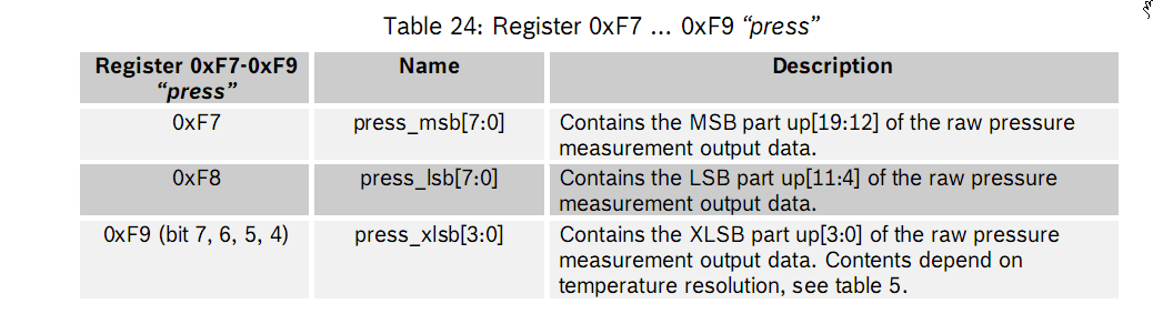

If the BMP280 has been setup correctly!
Should this get the byte from the PRESS_XLSB = 0xF9 address and show it on the 5110?
At the moment it shows 3xGSP lines updating ok and ALT=.

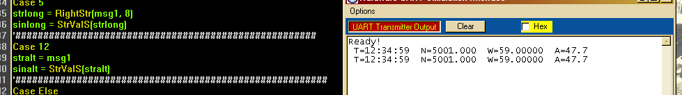

hi C,
This short clip from the 18F4520 basics, shows some options in converting hex values to decimal and ASCII strings
Run it in the SIM.

Hi E,
Thanks for the clip, it works ok in SIM. You've explained this few times in the past, I nearly get it.
Bearing that in mind. Looking at the #305 program, is it set correctly to get the DATA from 0xf9 on the BMP280 in the MAIN LOOP?
C.

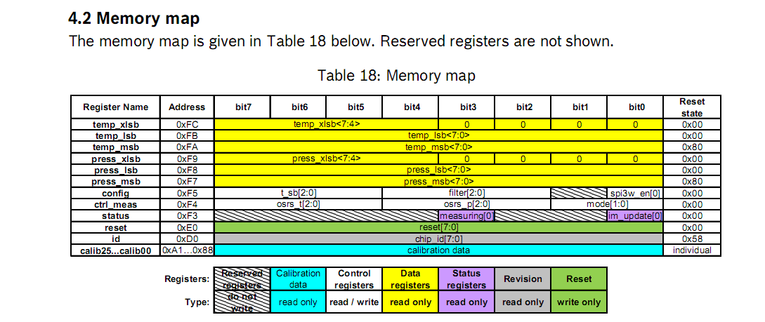

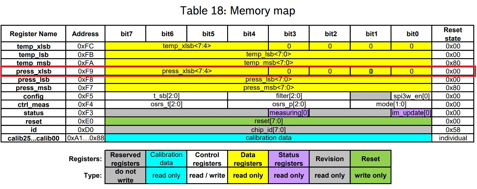

It is difficult to read, so I've edited it. As there are 2x of each BYTE i,e, PRESSURE MSB and TEMPERATURE MSB I have added P_. to the 3x PRESSURE bytes.
The DATA sheet shows that the P_XLSB uses only the high end of the byte. I presume that all the bits need to be shifted along, is this true?
C.

hi C,
What is the range value of the P_XLSB of the Byte and what displayed value do you want.?
eg: say P_XLSB = 0x12 what would you want the displayed value to be, is there any Scaling factor.
eg: 0x12 = decimal 18, this may need multiplying by a scaling factor say 100 , so that becomes 1800
Post a few P_XLSB values and the required displayed values.
E
