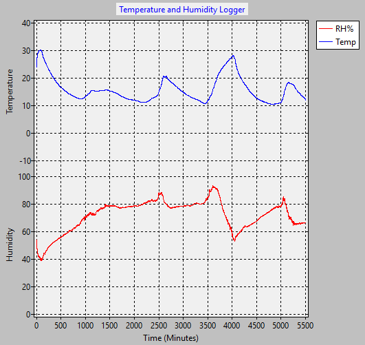

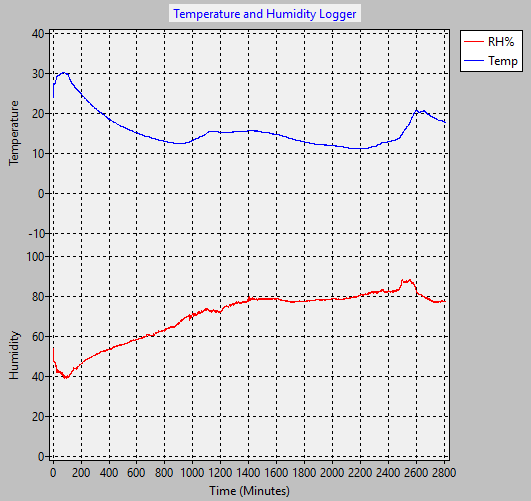

Just thought I'd show you what's been going on, it's been running (and still is) in my shed at the bottom of the garden, using the HC-12 wireless modules for the connection, here's a graph of the last 50 hours or so - it was beautiful Monday, and hit over 30 degrees in the shed, but not been so good since, and a lot of rain :( We did have a little warmer spell this afternoon, as shown by the peak at the right, interesting that there was a humidity peak shortly before though).
Incidentally, this image was saved directly to PNG from the Lazarus program, previous ones have been from PrintScrn and edited with Paint.

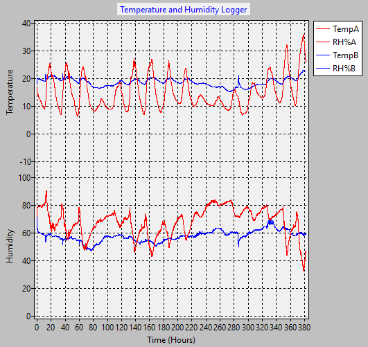

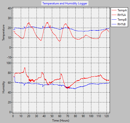

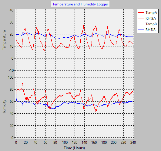

OK, been running five days now, here's the resulting graph.
Interesting to see the daily temperature peaks, although Tuesday was a bit of a crappy day :D
I'm also a bit puzzled as to why Wednesday, Thursday, and Friday all have a humidity peak just before the temperature peak?, presumably Tuesday was just too crappy for anything to happen.
Maybe the humidity peak preceding the temperature peak could be explained by evaporation of overnight dew?

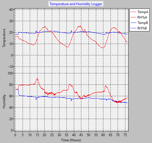

Just to keep you all up to date, here's a current example using two wireless temp/humidity sensors, the red trace is outside in my shed (at the bottom of the garden), the blue trace is upstairs in my attic workshop - the very first part of the trace isn't relevant, it was just some manual testing done before the run. Hopefully this shows my insulation in the attic is doing something :D
The three temperature peaks are Monday, Tuesday and Wednesday afternoons. I'm presuming the tiny blips on the blue trace are when the sun shines directly through the attic roof window?.
Overall I'm pretty impressed with what it shows, and I'm planning adding more sensors and traces.

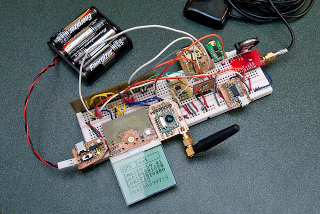

I made a datalogger a few year ago, but never took it off the breadboard. I was going to take it on hiking/canoeing trips to track weather and my location throughout the trip. Once I made it on the breadboard and got data to the microSD card, I kinda lost interest in it. I put a RFM12B RF module on it, but didn't use it. I think my idea was to throw everything including the kitchen sink in case it was useful. It had atmo pressure, temperature, humidity, GPS, accelerometer (to track when I was moving).

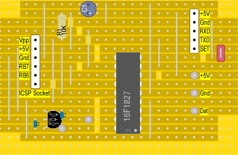

Here's a Lochmaster layout of the sensor I've just finished, the board has the corners cut off to fit in a plastic box, with the DHT22 mounted externally, on the end of the box, wired to the three pins at the right. The HC12 wireless module plugs into the connector at top right, mounted upside down. The PSU pins at bottom right are wired to a 2.1mm PSU socket mounted on the opposite end of the box to the DHT22.

Hi Nigel,
Am I correct in assuming that all 5 HC-12s are working on the same frequency and that you initiate a reading by transmitting an address from the HC-12 connected to the PC which causes one of the HC-12s in the remote units to send its data ? I have just started playing with a pair of HC-12s using a PIC12f1822 to convert the DHT22 data to an ASCII string. This is the circuit and firmware that I have used.
