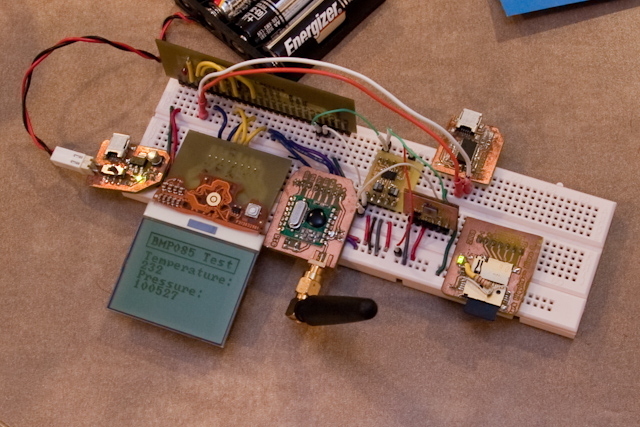

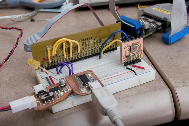

I just wanted to post a quick note on this sensor because it's pretty cool. I bought one to add to a datalogging system I'm going to use while canoeing. It'll have GPS, Pressure, Temperature, and Humidity. That's all that I could think of. So I bought this sensor and made up a little board for it.
The sensor has a thermometer and pressure sensor in it and the temperature is used to compensate the pressure data. It doesn't do this itself, you have to do it. There is also a bunch of encoded calibration data in the chip itself you need to take into account. So there's a bunch of coding you'll need to do on your microcontroller.
I just pulled all the calculations from these arduino sites where the code is simply based off the datasheet, but slightly cleaned up. Looks like you can get a breakout board from the first link; second link shows that if you are pretty careful you can directly solder some small gauge wires. You only need a few connections.
Anyway, the thing can really tell the difference in pressure every few feet, even at its lowest resolution. Here it is showing the data its getting. The temperature is in degrees Celsius. I didn't bother putting in a decimal point, it's 23.2 degrees. Fairly warm. Temperature data seems much more sensitive than the LM75. Putting my finger on it, it immediately jumps several degrees, very quickly. The Pressure is shown in Pascals and it's about 20 Pascals difference in the Pressure at my feet compared to at my head height.

This is a better picture of the sensor mounted.
