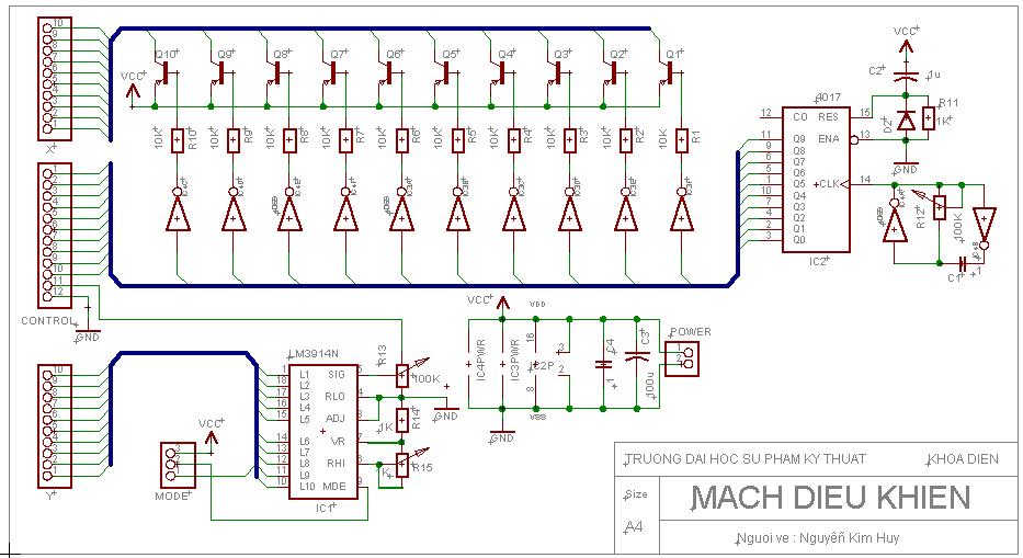

Can a 2N3906 be used for Q1 - Q10? the schematic is below
(the circuit is fed with 15V, according to the power supply draw)
The original Oriental circuit uses the LM3914 with its outputs set to 12.5mA directly driving the cathodes of the LEDs. 2N3906 transistors driving the anodes of the LEDs will be fine with such a low current.
But multiplexing reduces the average current in the LEDs to only 1.25mA so they will appear extremely dim. Many things need to be changed to increase the current.
oh yes I forgot to say that, I'm using LM3915 because I have seen your warnings about the dim light, cannot find LM1916
The LM3916 is a VU meter LED driver. The input voltage step spacings are all different.
The LM3915 is a logarithmic LED driver. Each input voltage step is 3dB more than the LED below it.
The LM3914 is a linear LED driver. Each step is 10% higher voltage than the LED below it as a voltmeter.
All three LED drivers have a max output current of about 25ma which is nice and bright without multiplexing.

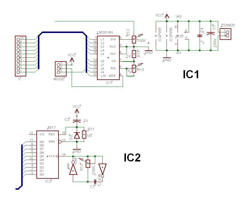

Thanks by the data, Audioguru. I got the board etching done, but before go shopping I'm worried about this Eagle's warning (don't laugh)
WARNING: Sheet 1/1: POWER Pin IC2P VSS connected to GND
WARNING: Sheet 1/1: POWER Pin IC2P VDD connected to VCC
Vss must be 0v, so what's the problem connecting it to gnd? should the oriental circuit be redesigned??
WARNING: Sheet 1/1: POWER Pin IC1P V+ connected to VCC
WARNING: Sheet 1/1: POWER Pin IC1P V- connected to GND
another thing, according to datasheets the LM3914 and LM3915 share the same pinout, but could be used indistinctly with the oriental circuit? (I prefer the shame of asking, instead of blowing the money up)
pd: schematics included below

The average LED current in the Vietnamese project in post #30 is only 1.2mA which will appear very dim.
