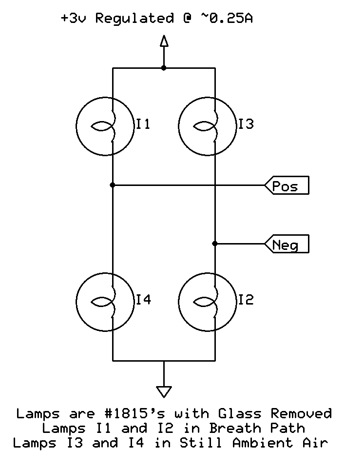

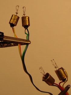

If you're not looking for accuracy, but only peak flow indication, you could use a simple hot-wire anemometer concept. This is what I was playing around with at one time. I used four low-voltage lamps, with the glass envelopes removed, in a Wheatstone bridge. Two filaments are placed in the air stream, and two are placed in still, ambient air. The output was direct to the o-scope, with no amplification. The breath signal-decay slope is related to the temperature and thermal mass of my filaments. The small pulses on top of the flow was just some puffing.
This can be done with tiny thermistors and a differential amplifier.
